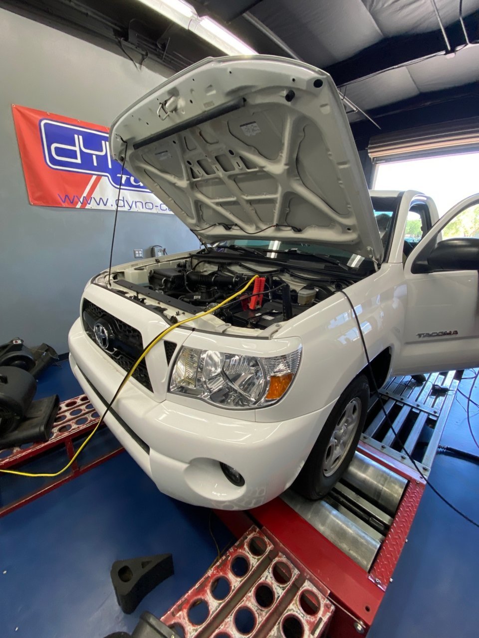

    No baseline is done. The photo is tuning this but it’s not ready for prime time yet. And truthfully they are still making adjustments. The vendor really didn’t want to say anything but I thought I would let you guys get a sneak peek of what’s hopefully coming. Please do NOT contact the vendor because they won’t have anything to say. They do NOT want to release anything until it’s proven and ready to sell to the general public. They do not build something then let Joe Public be the guinea pigs like some others do. Again PLEASE do not contact the vendor as it’s not ready or available yet. I volunteer our newly acquired unmolested 07 for the test mule because I wanted to get from under URD. After I get the 07 back the plains as of now is to install another system on our 15. I was looking VERY hard at an LS swap but I’m thinking I may just stick with another supercharger system, this one. Plus I might just get in trouble with LS1 HP.
    *EDIT*
    Guys please know that this is a quote from the vendor in an email to me today 7-2-21.
    “A tentative soft release date is 3-4 months out”.
    Again guys the vendor is not going to release anything until they are comfortable with all the testing. I apologize & I know I jumped the gun but remember anything worth having is worth waiting for. This vendor is not URD, G has known for many years about the issue w/ Rotrex.
    So save up your pennies so you are ready when they are ready…

    Oh shoot! I couldn't even see the blower. Blended right in.
    Well done!

    Perfect day for a dyno. ;) When setting up systems to run well in worst case scenarios.
    Quite curious for the coming updates. Should feel quite a bit stronger. :thumbsup: I'd really like to see either the dyno, or the dynos compared. To see where that torque comes in.

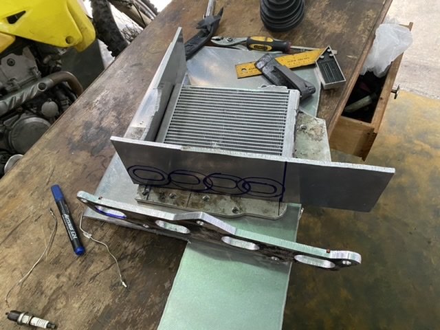

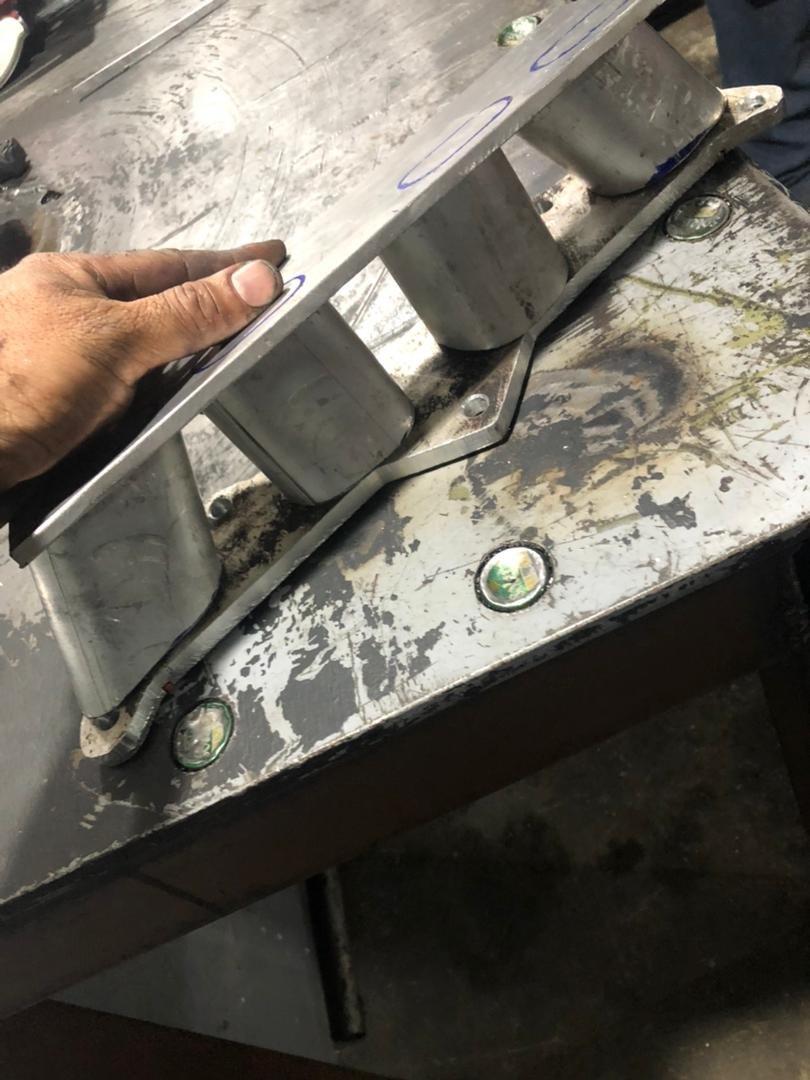

    1- ecu fueltech 500 2- alternador mechman 240amp. 3- dual comp kit de embrague (LCE performance 385hp). 4- volante alto 30libras (LCE PERFOMANCE). 5- kit tren de válvula calle (LCE PERFORMANCE). 6- kit de cambio corto (LCE PERFORMANCE). 7- header (LCE PERFORMANCE). 8- resonador borla exhaust. 9- espárragos principales ARP. 10- inyectores de combustible 440cc (LCE performance). 11- afe power throttle body spacer. 12- bomba de combustible AEM. 13- kit de mangueras de radiador HPS. 14- Bloqueador trapero 100% ARB. 15- relaciones delanteras y traceras 4.88 G2 Axle & Gear. 16- filtro de aire K&N.

    Nice work Wilmer!

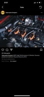

    What do you think of this coil packs? If you feel like HP, what do these people say?4E6AFE31-0811-4205-8B89-2A129E08F4AE.jpg

    @12TRDTacoma did you ever get a datalog with your coil packs? Any noticeable improvements?
    @JustDSM , have you tuned any trucks that have those coil packs?

    Nothing to date.

    I did get a datalog. If I remember right Justin made no changes to the tune with them. The only thing I noted was a smoother idle. They seem to pull the same across the board. Maybe a little more mid range. I'd have to check the email exchange between him and myself to see what exactly he said. I just don't remember when I did it.

    so no known hp gains yet? I know who the manufacturer is but i thought we would have heard something by now.

    I want to buy this coil pack but I'm not sure if what these people are saying is true or a lie I don't want to throw my money away

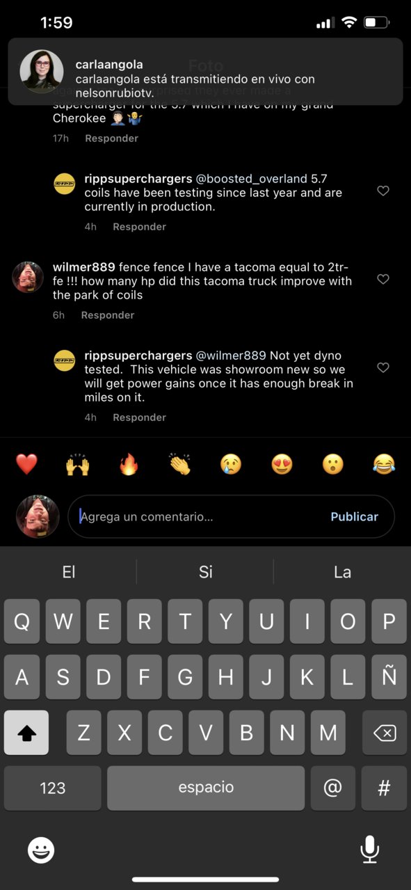

    the folks at @RIPP REPLACED ME THIS I ASKED THEM A QUESTION: Not dyno tested yet, this vehicle was new to the showroom so we'll get power gains, it has enough margin in miles1F27E0AE-A931-4A5B-8739-61D158F7569A.jpg

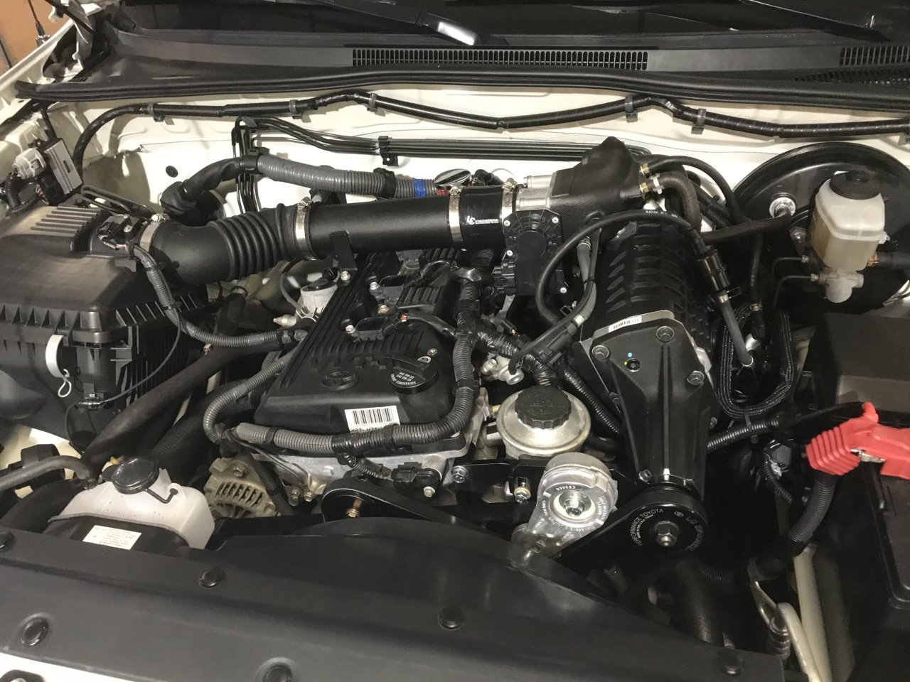

    Just curious has anyone seen a Dyno run with a stage 1 Rotrex.
    I will say the Magnuson feels much more “linear” in the power delivery from the best I can tell with my out dated butt Dyno. The Rotrex was on our 15 with a LCE header, 2.5” exhaust w/ single cat & a gear swap. I originally changed the 15 2TR w/ a stick in steps.
    #1 went from 26.8” to 28.6” rubber so that dictated a gear swap from 3.31 to 3.73. (Best bang for the buck) #2 the header & exhaust w/ 5x11x22 Magnaflow. #3 removed 2nd clean up cat and replaced it with 5x8x14 Magnaflow for sound :thumbsup: & helped giddy-up. #4 the Rotrex #5 Removed Rotrex. :D
    The Magnuson is on our newly acquired 27k mile 07 2TR w/ stick & it’s 100% bone stock other than the supercharger. That’s what the vendor wanted. The Magnuson goes back to the tuner on 7-27-21 for more adjustment. It has a random flat spot approx 35-3700 RPMs that’s very sporadic & depending on throttle position. When everything is completed I will then do my other modifications. Again we don’t want any issues when the Magnuson is available. Guys I’m really saying a LOT more than I should but you can be assured it will definitely be worth it. As of now I was given a retail price, I was pleasantly surprised.
