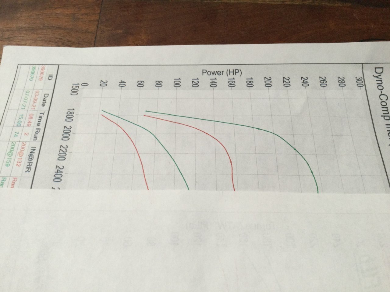

    Oh, and if you look @ approx 2500 RPMs the stock HP is under 80 the Magnuson is under 120 HP that’s almost 40 HP @ 2500 RPMs. I don’t think that’s to bad considering the max stock HP is @ 150 to the wheels. Anyone else agree?

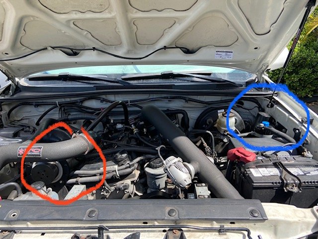

    So after just under 10k miles, the Rotrex unit is making some familiar noises. It is on its way out - again.
    Now before the "see, this is why _____ sucks" or "I would never buy/trust _____" bashing happens, I'd like to point out that this is NOT meant to be, in any way, a "bashing" post of any kind. I'm simply reporting what has happened to me, just to provide information if you have or are considering installing this particular system on your truck. Had I been provided the same information, I am sure it would have been helpful in my considerations. Let's try to be helpful without being hurtful.
    In discussing this latest issue with the rebuilder, he sent me a copy of Rotrex's Technical Handbook. Of particular notice is how the serpentine belt should be oriented on the pulley. Notice that they recommend the belt be moved to the innermost rib on the pulley (lower image):
    However, in the installation directions from URD, they say the belt needs to be on the outside rib, opposite of what the Handbook says (lower image):

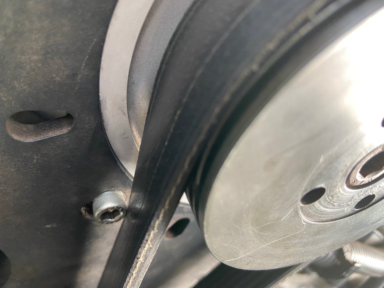

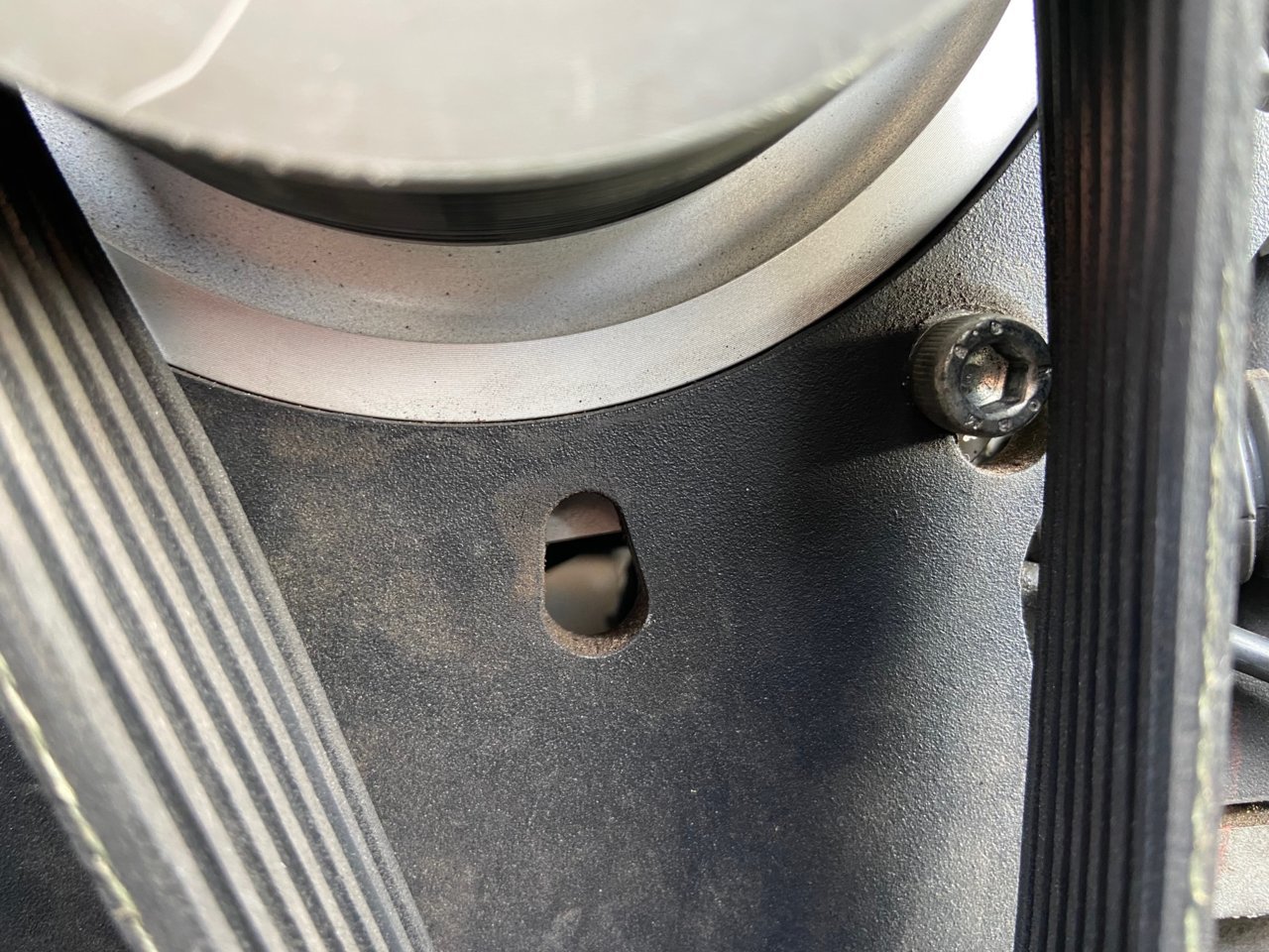

    I couldn't get a good picture of it, but 23mm from the supercharger bracket face (as mentioned in the Rotrex document) measures to just inside the center of the pulley - which means, when mounted on the outer rib of the pulley, the center of the serpentine belt sits over 23mm from the bracket face.
    So I then tried to connect the charger in the belt system the way Rotrex describes. However, it cannot be run that way, as the belts strike the mounting bolt heads:
    While there are 12 mounting holes on the bracket provided, I cannot simply rotate the charger mounting holes one hole over, as it rotates the charger by 30 degrees, which is too much of an angle to allow the internal oil pump to work properly (the maximum deviation from horizontal is just 15 degrees.) And while I could fit shorter/flush mounting screws, keep in mind that the kit was designed to run with the belt on the outside rib, so moving to the inside rib will likely create some twist in the serpentine belt (rib to rib on the pulley is a few mm I think), which in the best case scenario, will reorient itself to the outside rib, or in the worst case lead to other increasingly bad issues.
    In reviewing more of the Technical Handbook, it says to prevent oil leakage, the charger should be higher than all other parts of the system (red print in second paragraph):
    And, the blue cap of the traction fluid reservoir should be at the same height of the charger shaft (first box and description at bottom of page):

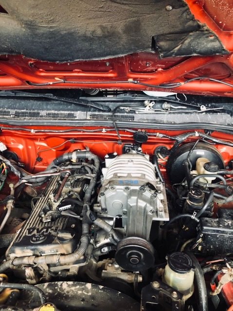

    However, if installed as directed, the there is no way to get the blue cap at the charger shaft height, as it is flush with the fender well beneath it where it is currently mounted, and, at best, is at equal height to (or slightly higher than) the charger (charger circled red, reservoir circled blue):
    All that to say, it seems that the mounting bracket for the Rotrex unit has the charger sitting too far back and too low in the system to be installed in compliance with Rotrex's Technical Handbook. Which means, if I get the unit repaired and reinstall it, I'll likely come to the same conclusion - unless the mounting bracket is modified and I relocate the oil reservoir.
    I'm not sure what I'll do, to be honest. The truck is currently running without the charger connected and it is world's different to drive; will likely go the same route that others in my shoes have and begin assembling pieces to turbo. It was fun while it lasted, I guess.
    To be continued. Let me know if you have any questions and hope this helps some.

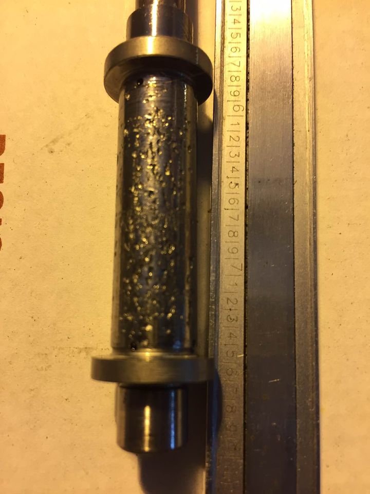

    Here's a picture I found on the web of a heavily pitted Rotrex shaft. I wonder if that traction fluid is the real problem with those setups but the shafts seem to take the real beating.
    Torspd likes this.

    From everyone I have spoke to they all said the “Shaft Snap or Broke”.
    Like I said before Carlo the GM at the shop that tuned the Magnuson said his buddy that lost 3 in a racing season all of then the shaft failed.

    I think the shaft breaks when the main portion seizes (inside the fluid area) and the momentum transfers to that narrow portion which then snaps. It's a nice compact head unit, but obviously the design doesn't work properly or they wouldn't break so easily.
    Torspd likes this.
