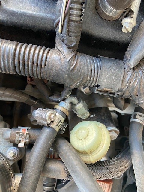

    Those who have used or are familiar with the URD system, need your help. Decided to remove system entirely since it will be a long while before I pursue any other direction (if at all). Since I bought the truck with the kit on it I need help in knowing where things are supposed to be go once I remove the system.
    This (circled) is just above the intake manifold and between the first and second cylinder:
    It's T-ed to the boost gauge sensor, the blow off valve, and the elbow on the air box feeding into the charger intake (circled).
    Can the T connector in the first picture be replaced with a male-male connector to splice the tubes together, or does the T remain and get connected to something else?

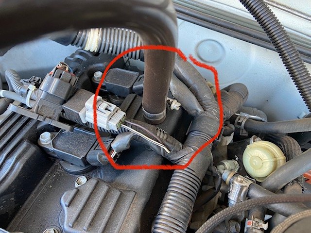

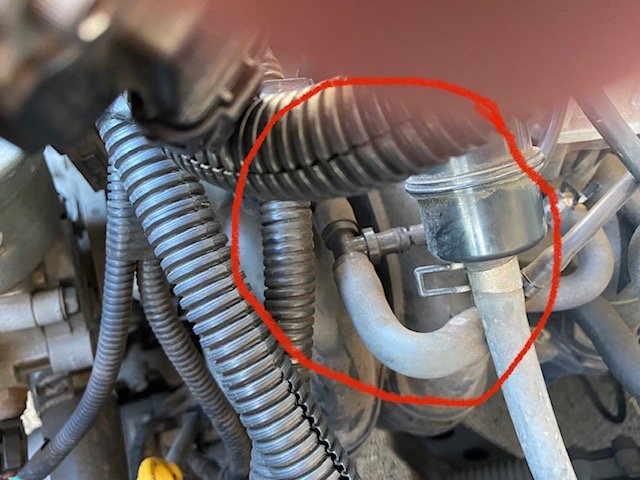

    Second question - what is the proper way to remove the 5th injector? Picture shows how it is connected.

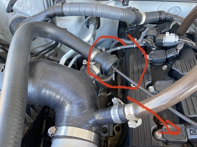

    Third, I presume the PCV tube can be removed and the port covered with an appropriately sized air filter, correct?
    I'm not sure I can find (or want to buy) the stock tube and resonator from the air box to the throttle body, so I'm unsure if there are obvious connecting points to the tubes mentioned. What I'll likely do in the interim is make a tube that connects directly from the air box to the throttle body that has a connector for the vacuum tube. I have some of that Airraid intake tube and some connectors laying around which I can probably make fit. The MAF can go back in the stock air box.

    This is a factory hose that was cut into. You can get another one and replace it or just cap the tee off with a vacuum cap from any auto parts store
    I think just throwing a filter on would create a vacuum leak. I would route this back into the intake pre-throttle body like it was stock
    To remove the 5th, you need either a plug for the fuel rail tap, or you need to get some shorter bolts, remove the tap, and then plug the damper back into the fuel rail like it was stock.
    this depends largely on how it was installed. The jumper harness to make things plug and play did not come with mine, that was an extra 250 bucks. Any easy way to tell would be to pull your glove box and poke around some down there. There are two wire harnesses that come out of the MAPECU3, you’ll want to see where those tie into your stock harness or a jumper harness

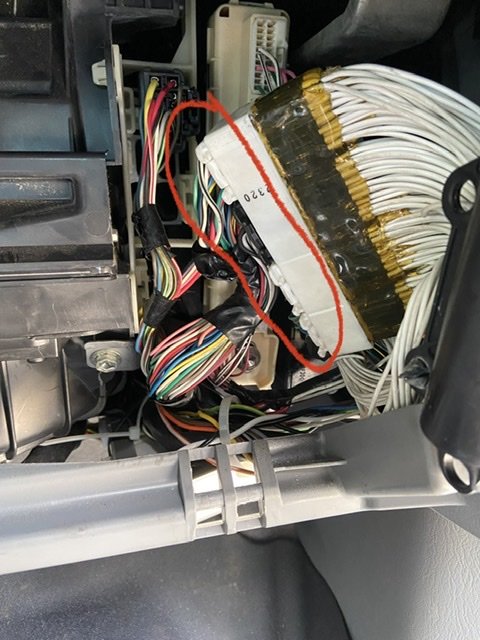

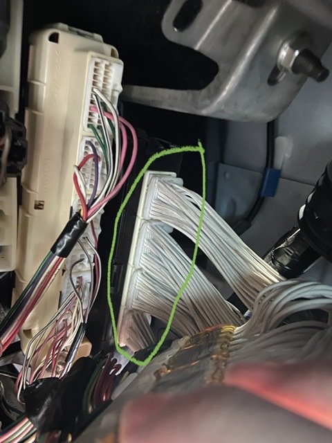

    So finally did some poking around behind the glove box and found this, and just want to do some double checks before I proceed. These (circled red) are the stock connectors that will go back directly into the stock ECM, yes?
    Behind this, is what I think is the stock ECM. Plugs from previous pic go directly into here (circled green), and MAPECU and harness will then be out of the system, correct?
    Gadget sent me this ECM diagram; it looks to be different from the 2013 one JL8Jeff attached, but it does look like each should plug into it's own slot (they are similar sized but not the same).
    I know there is also a vacuum line and the 5th injector wire that will need to come out of the engine bay from the MAPECU. I’ll cap the injector feed and vacuum port that the MAPECU connected to once everything is out.
    After that the intercooler and associated plumbing will be removed (already got a hood latch brace), and I'll make an intake tube directly from the airbox to the throttle body with inlets for the PCM tube and vacuum line. Am I missing anything?
    I'll be sure to disconnect the battery as well as take any other considerations anyone might have before I get to removing it. Thanks in advance for helping me double check!

    Yes, those will go back into the stock ecu, and there’s only one way they can go. Just did this on Saturday actually haha, but the opposite way
    Make sure you use the same diameter tube as stock/the urd sc tube where the MAF mounts. The scaling for the MAF is based on that diameter.
    also I’d recommend getting an o-ring for when you remove the fuel rail tap/5th injector. I used part number 90301-07037
    Yes that is correct

    I have some of that 3" "make your own intake" tube that will run from the throttle body to the stock air box, and the MAF will go back to its stock location in the air box. The air box outlet and throttle body inlet are about the same diameter, so thought it should be fine - though I don't know if it needs to be stepped down at some point throughout.
    I'm planning to just put a 1/8" NPT plug in the fuel rail tap (something like this) with some PTFE thread sealant, and leave the tap in there, as plugging the hole seemed simpler.
