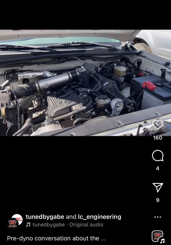

    Also well being you’re in So. Cali. then you should be close to LCE in Lake Havasu. Here’s a short video the tuner son made. You see what they use! Make sure to enlarge it and tab on the volume in the lower right corner.
    https://www.instagram.com/reel/CefIZv_g-6R/

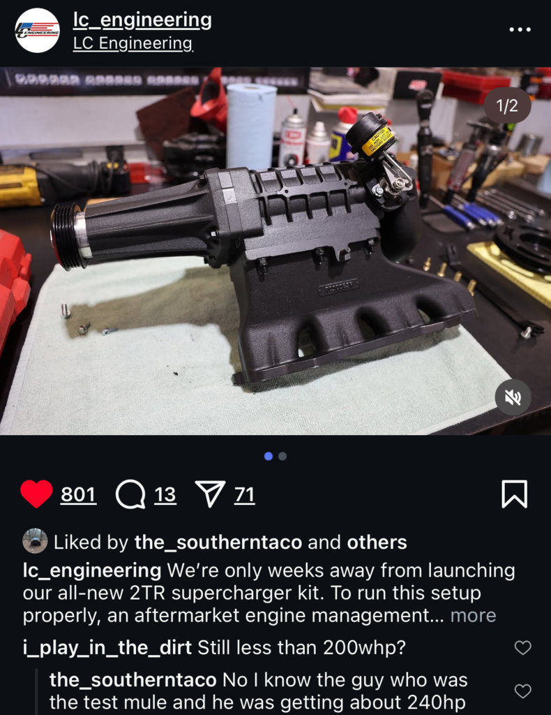

    LCE is about to release their Magnuson SC thats a twin screw. I would wait for that.

    Here’s some pics from their IG. They’ve been working on it for years. They said Preorders will start soon….
