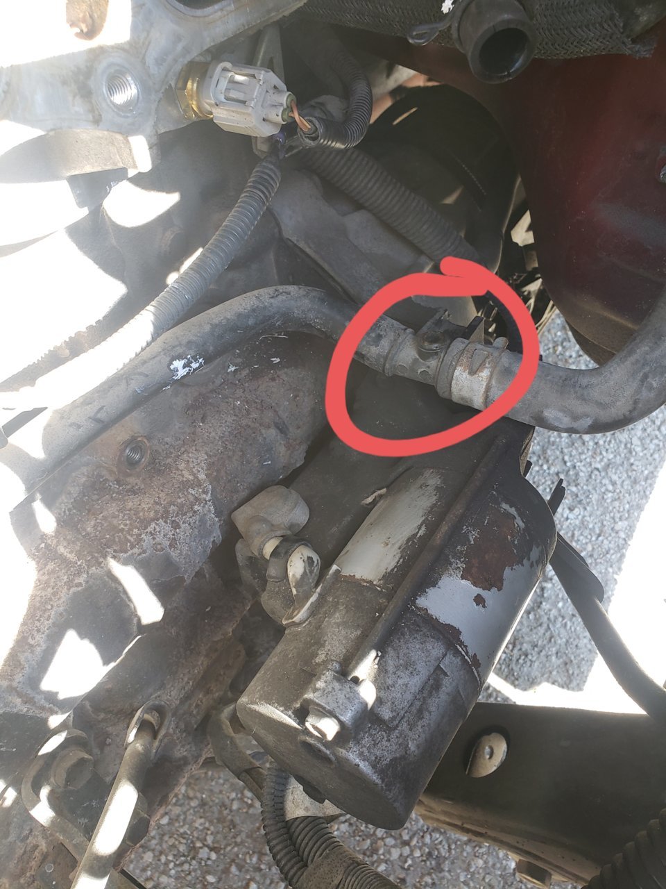

    Can someone confirm that this is where the coolant hose off the throttle body should attach and that the male part is broken?
    It must have yanked out when removing the manifold .. the clip was still attached and there was some bits that were super worn out but could have been plastic.

    Nvm.. figured it out.. def broken water bypass pipe

    Yep, time to replace it with a metal one. Mine started leaking at the other end, then that little fitting snapped off. Plastic crap.

    Yepp.. I think mine is leaking out the other end as well.. bunch of red-pink crystals around the flange... ordered an oem metal one off ebay for 59$.. stealership wanted 157$ and they had to order it anyhow. I laughed.

    I picked one up at Autozone for $45. I wasn't looking forward to pulling the intake off, but the job was easier than it looked.

    Wait.. you got an oem metal water bypass pipe from Autozone?!

    No, it’s not an OEM part, but it’s definitely better than the pos that I replaced and I didn’t have to wait for it to be delivered. Rock Auto has the plastic ones for 6.25
