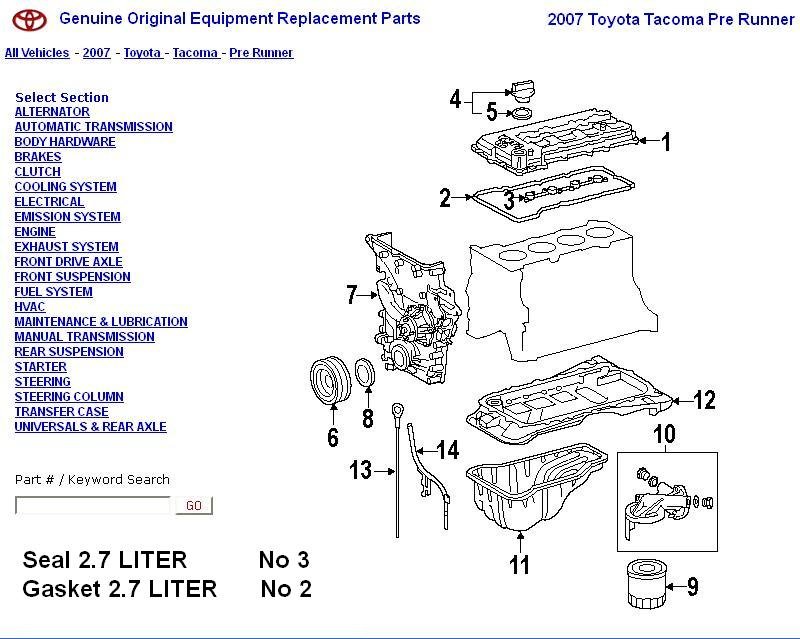

    Are you referring to: No. 2 and No. 3
    These is what I going to order. Do I need to order anything else?

    TurboBoss, #2 and #3 are correct. They both come separately. You do need to order anything else to replace the gaskets. I am not sure why I called it the coil pack gasket, I think someone at the parts department called it that. But good luck when you fix it! :thumbsup:
