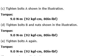

    I don't know if this helps, and perhaps you already did this procedure, but the FSM has a "three-stage" tightening procedure where the center is tightened, then the outer, then the center again.
