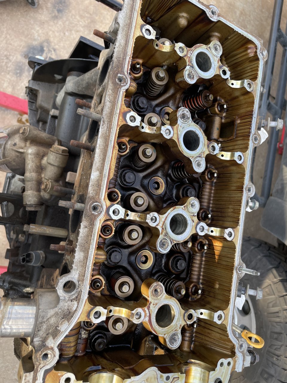

    It’s a 2009 2TR with a little over 272k miles on the rotating assembly but the cylinder head, timing chain guides, and cams have only 135k. I did a short block swap a couple of weekends ago and after that this began. Last weekend I pulled it back apart and swapped the lifters to the ones with 272k miles and it still makes the same noise, so im starting to think it’s not lifters as well.
    Since I got this motor at 150k, I’ve always changed the oil with full synthetic at 5k mile intervals so i dont think there’s a sludge problem.
    Here’s a pic of the 272k cylinder head. This is not the one on the truck, but the one that is, is way cleaner than this
