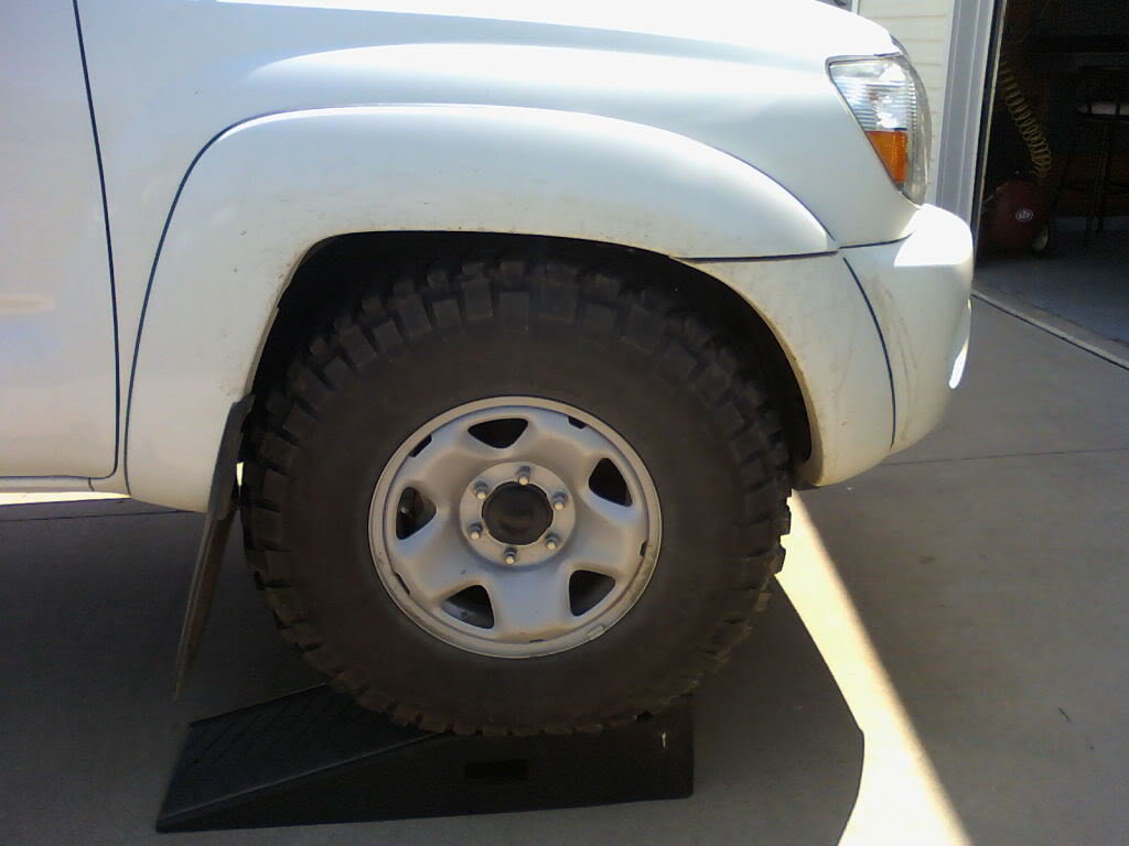

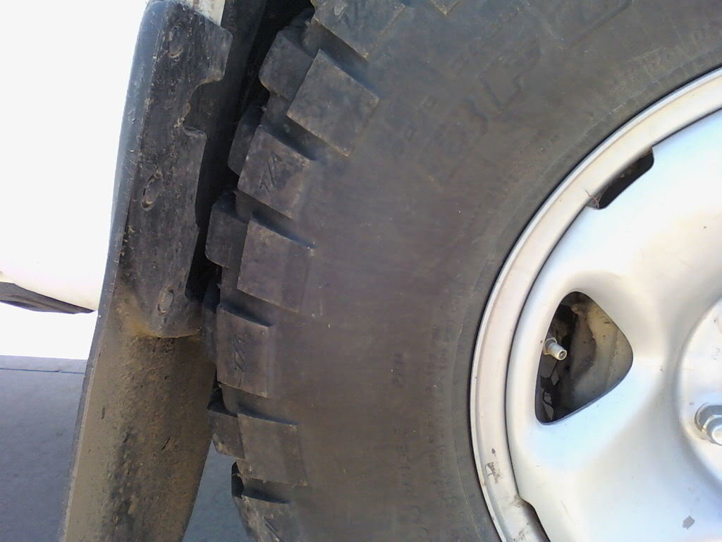

    To be honest, I didn't have to trim at all with my 255/85/16 KM2's. When they did my alignment, I had them set the caster forward just a touch. I can still run my mudflaps, but just barely. In the rear, on the passenger side at full stuff the tire "nibbles" on the front of my fender flare. This could be from my wreck I had last fall, though.
    Here is a pic of the front stuffed, notice how close it is.
  11. Apr 30, 2010 at 8:09 PM
    #71
    drew02a
    drew02a Rocking your mom's world Since 1997
    Jan 26, 2009
    #13005
    3,177
    San Antonio, TX
    2006 Regular Cab 2.7L 4x4
    Hell yeah man, that's exactly what we needed. What kind of lift do you have up front.
  12. Apr 30, 2010 at 8:15 PM
    #72
    gtrotter
    gtrotter Well-Known Member
    Mar 1, 2010
    #32351
    396
    Interlake, Indiana
    2009 Regular cab 4x4, ARB's, 4.88's, bumpers, 2017 DCSB SR5 stock,2008 Reg. Cab 4x4
    locker,mud tires, lifted, toolbox
    I am running OME 885 springs( the older style that lift a bit more) on Bilstein 5100 struts set at stock height. I removed the sway bar as well.

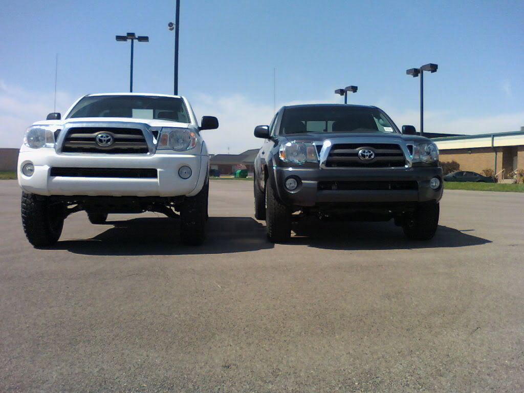

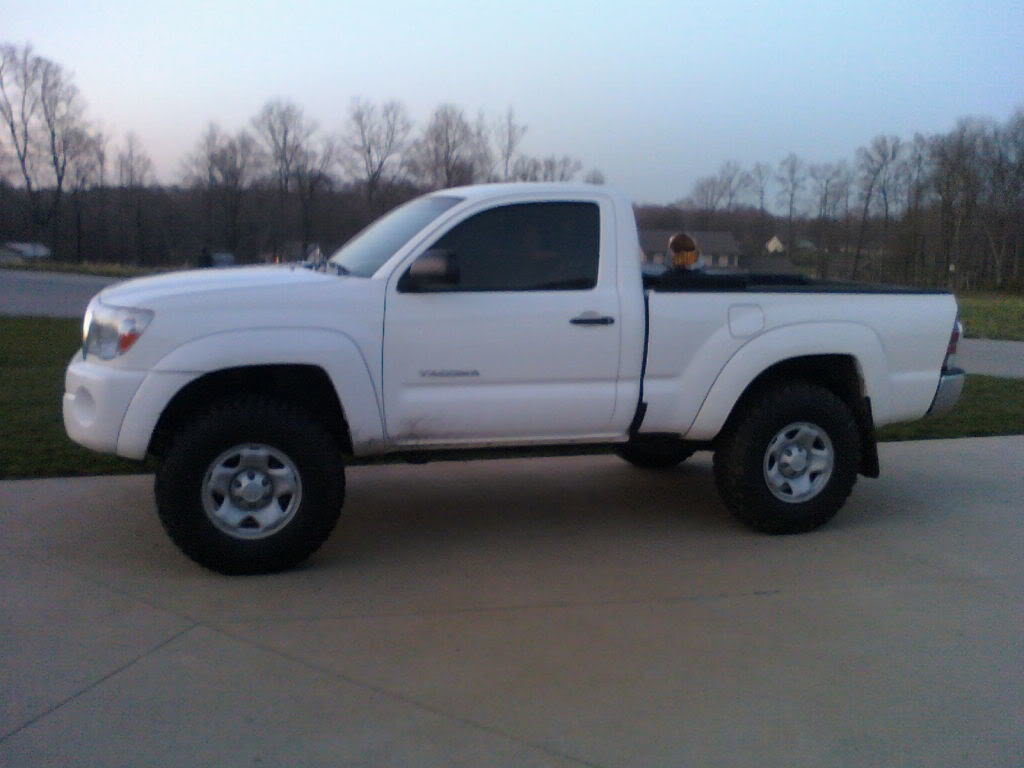

    Pics per request of customz
    Next to a stock TRD offroad tacoma
    Rear has an AAL, but is sagged horribly, to the point it is actually below stock levels.
  14. Apr 30, 2010 at 8:43 PM
    #74
    TacomaTSP4
    TacomaTSP4 Go Big or Go Home!!
    Aug 15, 2009
    #21220
    1,471
    Travis
    Rohnert Park, CA
    what are you carrying in the bed that is making it sag that much?
  15. Apr 30, 2010 at 8:49 PM
    #75
    gtrotter
    Mar 1, 2010
    #32351
    396
    Interlake, Indiana
    Not too much, nobody can figure out why my truck sags like that. The toolbox weighs maybe 100 lbs. I can easily pick it up and take it off the truck by myself. I do haul a 4wheeler sometimes, but I take the toolbox out when I do that. Even then, the 4wheeler only weighs in at 400-450 lbs tops.
