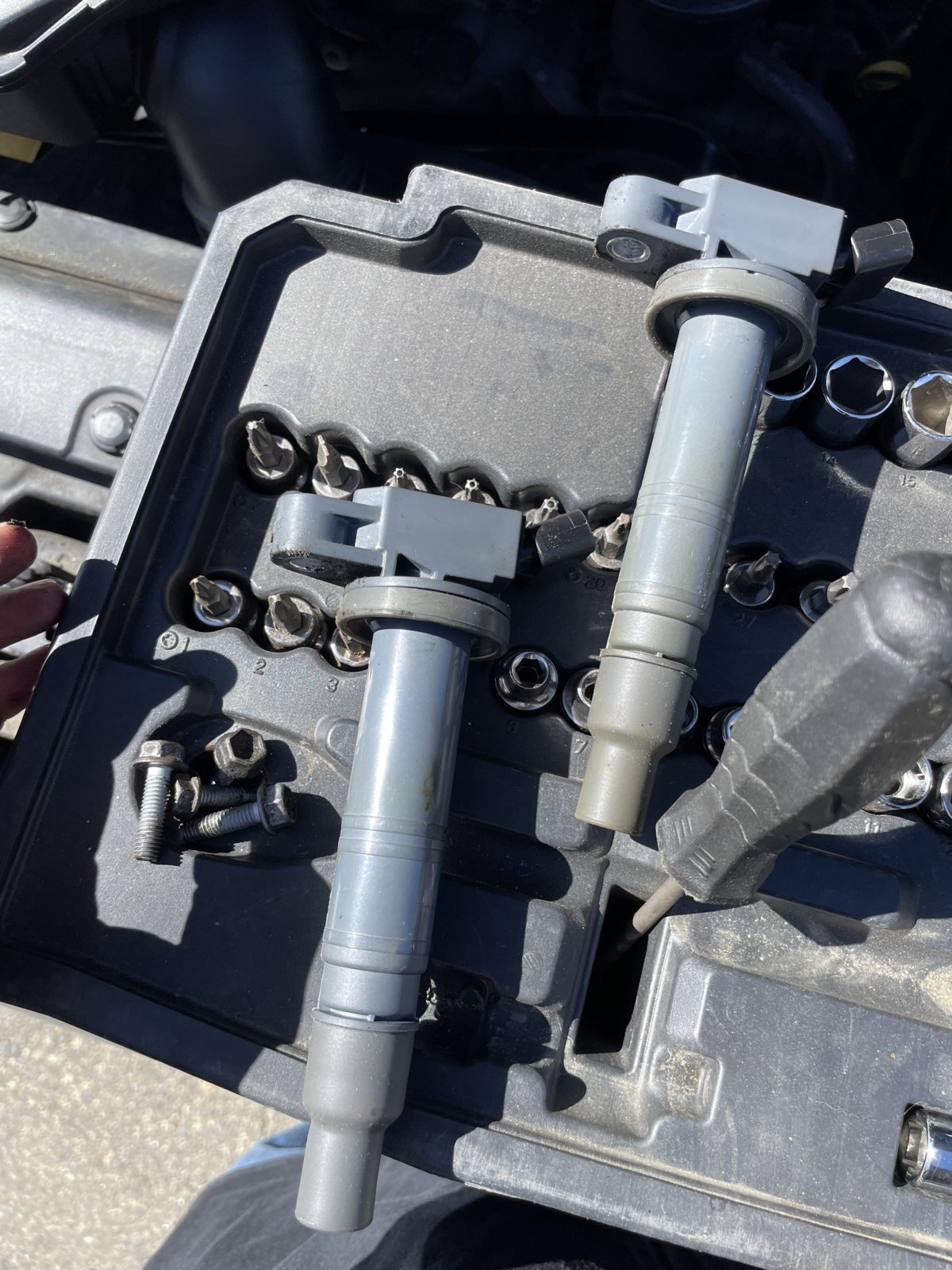

    yeah before installing the plugs i triple checked the gap. they were oem style replacement iridium denso plugs. just did an oil change same day as plugs, coolant is fine, transmission fluid could probably be changed but i have enough in there. i was thinking maybe coils? because i’m pretty sure i switched them around when reinstalling but i doubt that matters.

    Swap the 3 and 4 cylinder coil packs with the cylinder 1 and 2 coil packs and see if the code changes to P0303 and P0304. If it does, then your coil packs are going. In that case replace all 4 coil packs.

    If the coils come out dripping wet, it’s time for a VC job

    how do i know which is cylinder 1 and 2? swapping the coils right now.

    they all look fine to me what do u guys think. gonna do what zerkseas told me and swap and see if code changes.

    Cylinder 1 is at the front, cylinder 4 is the rear most cylinder.
