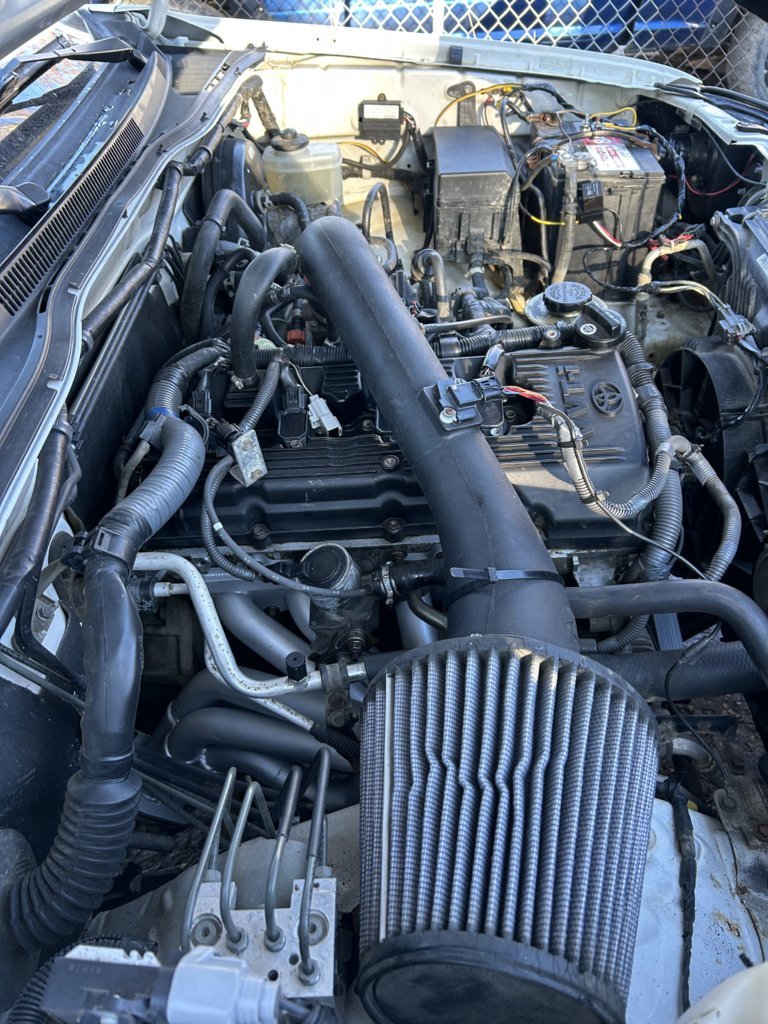

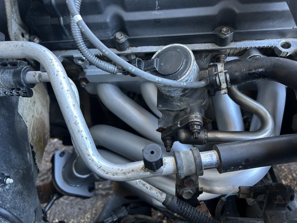

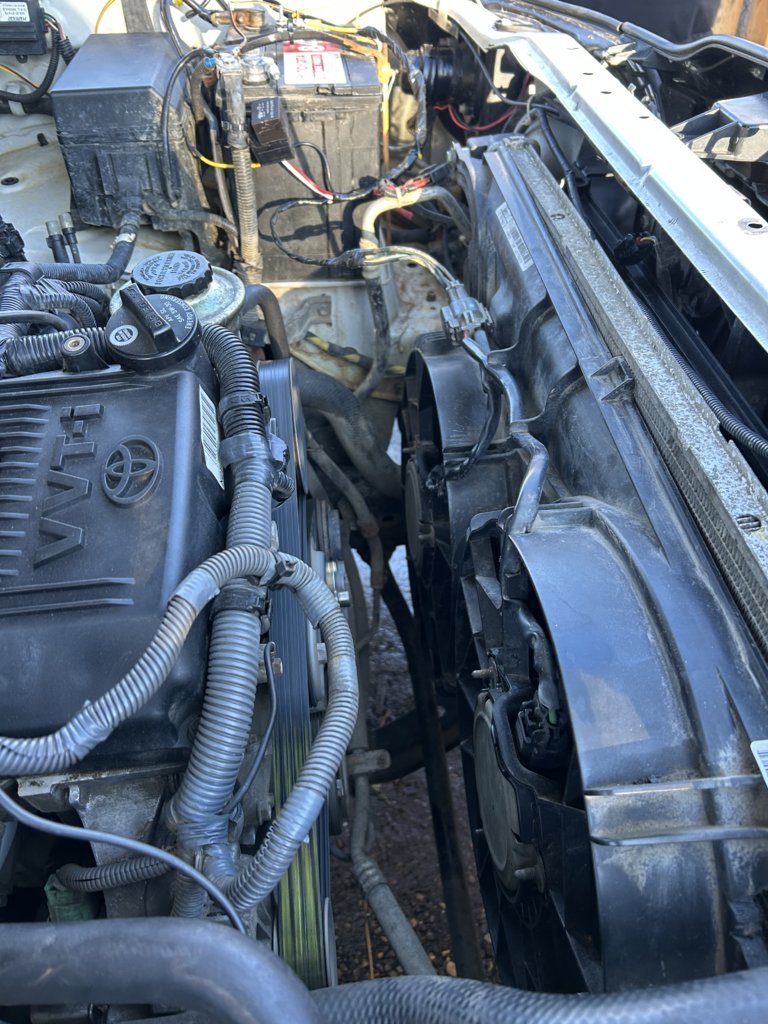

    New LCE header and wiring for the electric fan with circuit breaker and relay combo completed.

    Cool. How's it all working?

    Great if you do change the TB you must do a relearn and reset it or it's going to not know the position and rev hi took a few times. RPMs are way smoother and throttle response is awesome

    How's the engine feel with the clutch fan removed from it? I've got the electric fans set as a future mod hopefully to free up a bit of power in the engine.

    Engine feels better with the clutch. Fan deleted better throttle response definitely felt it more on my tundra versus the Tacoma free up the engine bay space. You have to use washers to take up the fans thickness.
