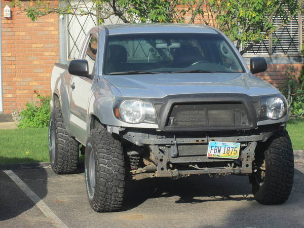

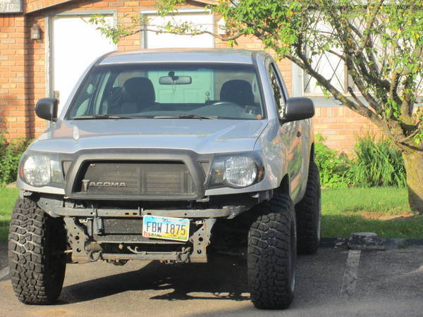

    Here is my trucko, now sporting some 32x11.5x15 KM2's with 4.30 Gearing.

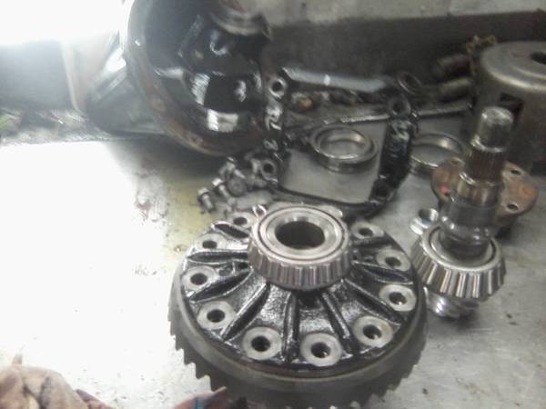

    How it went....it's a long story.
    Fuck NAPA. I ordered an inner pinion bearing from them last Tuesday. Guy made it sound like maybe Thursday, given Friday. Nope, fuck all that. I had major amounts of sand in my vagina about the topic, didn't even want to look at a truck all weekend.
    I did go to the local Toyota dealer Saturday morning though and ordered another bearing from them. Had to pay it for it and blah blah blah. Was told Tuesday it would be there.
    So today rolls around. The bearing has arrived from the NAPA fucktards!! WRONG FUCKING BEARING! Grrrrrrrrrrrrrrrr. This thing is way to huge, I could probably put the tip of my pinky between the outside diameter of the pinion and the inside diameter of the bearing.
    With zero fucks left to give and after my boss pissing me off to no end at the end of last week, I freak out on him and tell him that this truck is getting taken apart today. He knows the NAPA bearing is wrong and knows that I have a Toyota one on order. I proceed to take my truck apart, once again, with zero fucks as to how much it may have pissed my boss off and possibly being in a bay until tomorrow.
    Lunch time. Got an hour. 3rd member is out in about 20 minutes. Get it apart on the bench. Parts (Ring and Pinion) are right, THANK GOD!!!!. Pinion gear...I'm gonna see if I get can't this inner bearing off in a reusable state...we seemed to have accomplished that. Lunch over but not done. Now...I work in a damn transmission/driveline shop so I don't wanna hear it...I reused every goddamn thing...inner and outer pinion bearings and seal, all of it.
    Do a little work, then it's back to the truck, we reused everything, I gotta get this truck outta the shop. Ran into a little roadblock with shims. Very, very little, if any backlash with the OE shims. A little scramble and picking through a box of shims and my boss and I finally back to getting along and we've got her shimmed up with some backlash. Gear pattern looked pretty good.
    3rd goes back in and truck back together. No time for tires, need to get it out. Throw the 30's back on and park it. Get the tires after work.
    5:00, yay! Smoke a cig and chill in some AC for 5 minutes then back in the shop. Rear tires on first. Now the front...had to grind the caliper bracket, I'd say I spent no more than 2 minutes per bracket grinding down the sides with a shark (very course)pad whiz wheel attachment. Front tires spin free with no hang ups. I will need to paint over what I grinded, but no time today. Do they clear? No. They hit the black box, that's it. Cut off the plastic part then removed those stupid little metal boxes that are back there.
    Hit the road and drove home. Everything seems ok. I didn't get much above 45 on the way home, takin it easy and step by step see how she runs.
    Initial impressions on power and what not are that the truck does not appear to be as sluggish as she was before.

    Here is this as well. Only pic I got of the 3rd while out.

    Tires look badass!!!! Rim color choice ....... Well, u know what I suggested. Hahaha
