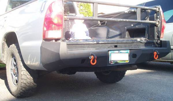

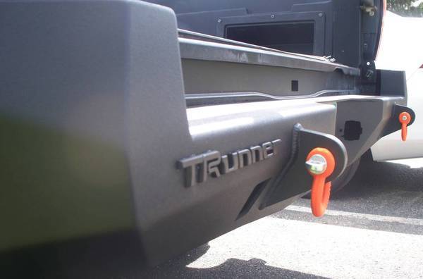

    - Bought 2 D-Rings and a can of flourescent orange spray paint. This is the ending result. Wanted some neon green paint, couldn't find any. Like the orange also, mesh's with the interior dash lighting and I'm a Bengals fan.
    - Going to pick up a couple black D-ring isolators. Paint/Bed-line the bumper and it will be a completed project.
    - Placed the spare back where it is supposed to go.
    - All in all, incredibly happy with the Brute Force Rear. Truck actually looks like a truck and no longer like a janky hunk of junk I threw together. Even the ol' wife gave a few positive comments regarding the bumper.

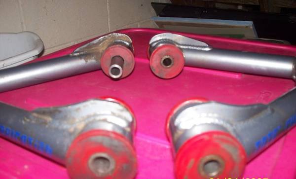

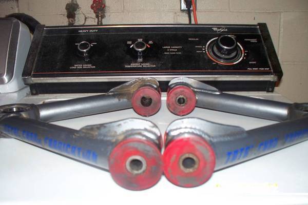

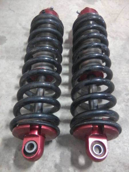

    - Got the sleeve for the UCA today.

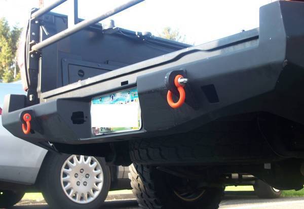

    - Better and more pics of the bumper/orange d-rings.
    (Thats my boy, Eli, hanging out in his dads truck)

  5. Apr 22, 2013 at 6:53 PM
    #25
    2TRunner
    2TRunner [OP] Don't give up here just yet
    Jul 30, 2010
    #40980
    2,999
    Around To Many People
    1, 2, 3, 4, 5 Lugs
    Brute Force Bumpers: rear & custom front tube, Saw-A-Way Racerunner 2.5 Coilovers with Total Chaos UCAs. Icon AAL.
    This weekend or next.
    I still need shocks and to reassemble the coilovers. Get those done and it will be a full lift set, ready to install. Reassemble COs tomorrow on lunch. Get shocks on Friday when I get paid.

    Brute Force Rear Plate Bumper.
    (Eli hanging out in dads truck, checking out the new bumper!)
    I decided to move the "TRunner" emblem from the grille to the bumper. Looks good there I think. Still need a "2".

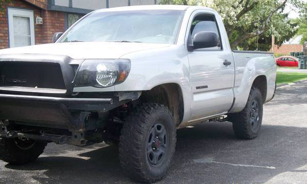

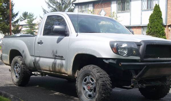

    Mid-Travel: Installed
    1 quick pic as my 1 year old boy is going nuts, I need a shower and We have a family meeting with a potential new dog.
    More pics later....
    Something is not right in the rear, looks bro'd out and I have the same ground to wheel well measurement in the rear post-lift as I did pre-lift.

    Time for bigger tires :p

    Naw, not at the moment.
    Posted this over Mid-Travel BS thread, but I'll quote it here to.
    More pics...

    That's odd :confused::confused: I would think the rear would be lifted some even with the front being lifted 3". You said you took the overload out but I don't think that would have decreased the overall lift by more than the lift gained by the AAL. Is the AAL used or new?

    New, but been sitting awhile.
    Just read something about which way they are supposed to be installed, gonna go see if I jacked that up.

    Went and checked. The D/S would be installed wrong if the longer end of the top AAL leaf is supposed to point towards the rear.
    However, I measured both sides from ground to fender well and the D/S at least has a .5" of lift to it.
    D/S sits at 34.5" P/S sits at 34"
    Got a feeling I'll be in contact with ICON...

    How much lift are you supposed to gain from the AAL? It's probably a good idea to check with ICON.
  18. May 4, 2013 at 6:47 PM

    Supposed to be like 1.5"
    Started a thread over in the ICON vendor section. Don't know how quick I'll get a response being late Saturday night, tomorrow Sunday.

    Just trying to think of whats up, or where the issue could be, but it's a pretty straight forward set up with a rear axle truck.
    The 1 AAL is backwards, but I wouldn't think it would inhibit the lift aspect, I dunno, talk to ICON about it.
    Center pin nut to tight or something?
    I got a plate bumper and spare back there weight wise.
