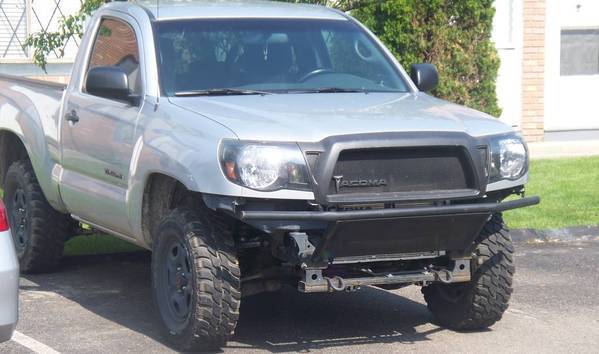

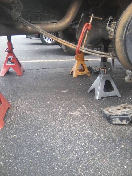

    Tore the rear end apart again today, several times. Answering the indents I had in the post above...
    All this on a 1 hour lunch break...(with minor prep work done during 2 smoke breaks.)
    - Nothing happened other than I saw my shocks still had several inches of downward travel left when I popped them off.
    - Switched the D/S AAL, only thing that I got was .5" lift on both sides, but at least it was pretty equal. The P/S had been a bit lower than the D/S, not even a full .5" on the P/S. They were both .5" after switching the AAL. Still not enough though.
    - Tore it back down again and removed the AALs from both sides. Had my sister pick up the AALs and take them over a place called "Frame and Spring". The service writer of my shop knows a guy @ F & S. They are going to re-arch the springs 2" for SPRING UNDER, guy sounded pretty confident about getting it done when I talked to him after he got the AALs. Should be done tomorrow. I hope to god this shit works and that I'm not a complete moron for doing this.
    Co-worker let me borrow his old 4Runner for the evening and to get to work tomorrow, pretty awesome offer, pretty cool guy, one of those Boston DBs, accent is fuckin great. Married to a former Buffalo Bills cheerleader though.
    This is how my baby sits in my work parking lot overnight. If anyone wants a little humor, I smashed myself in the face with that P/S drum when I let the last U-bolt nut go, it was an amazing time.

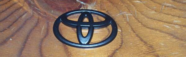

    I've had this mini Toyota emblem sitting around in my stuff for awhile. Found it or someone gave it me. Thought it might look good dipped and placed opposite of the 2TRunner badge on the B.F. bumper.

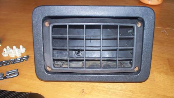

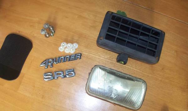

    Another Pick N Pull visit this morning, got some goodies. Starting to love that place.
    -Grabbed a front Aux light off an old S10, got it apart. Get a new light and switch, mount it in the d/s bed pocket.
    -Only Yota truck on the lot was a 94 4Runner. They raped it, took the front seats, front diff, all drive shafts, Tcase, rear pumpkin. I took the 4Runner and SR5 Badges, random bolts/screws, one of those gel holder things and some plastic door clips.

    Today's PNP grab
    Mount that light up like this, need to find a replacement bulb.

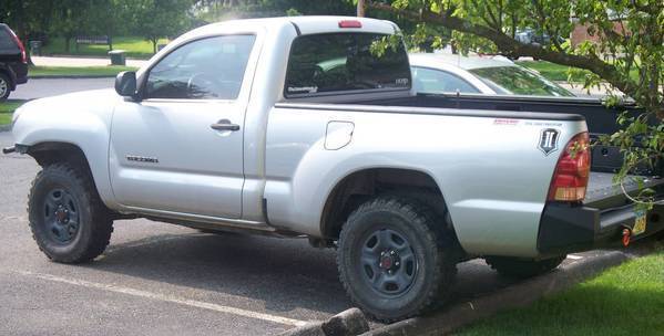

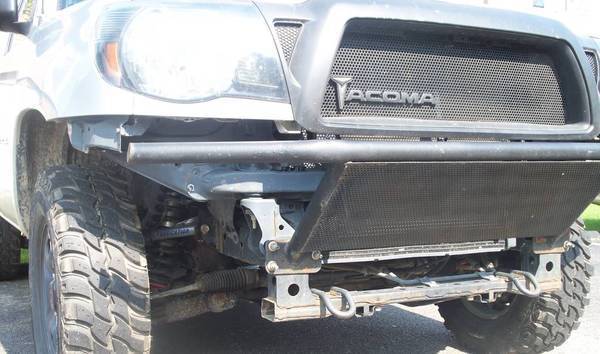

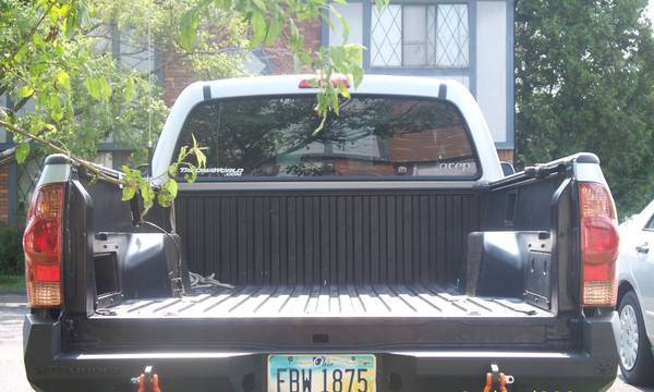

    Pics, post AAL re-arch
    Cleaned up bed. No more wire through the 3rd brake or running along the rail. No more stupid tube-gate. I think I'm going to tint the brake lights here soon, would look good.
    2TRunner and mini Yota logo
    I love this weekend shit...

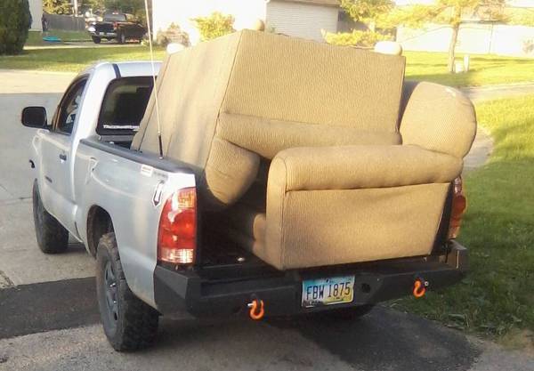

    Have become the neighborhood mover. Bout to put a sign on the truck! 2nd time in 2 weeks folks from the condo square have asked me to help em move something.
    -The itch to go wheel is getting bad now that MT is on.

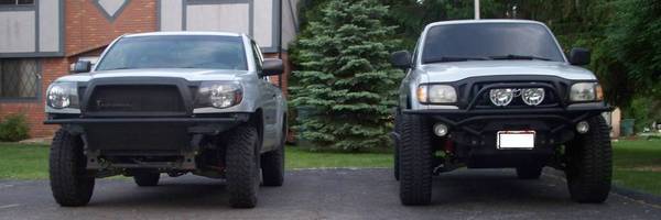

    Got a change to hang out with Kyle (Kmok) for an hour this evening and catch up, show off the Mid-Travel...of course. Those 1st Gen ain't to shabby themselves!
