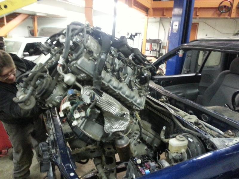

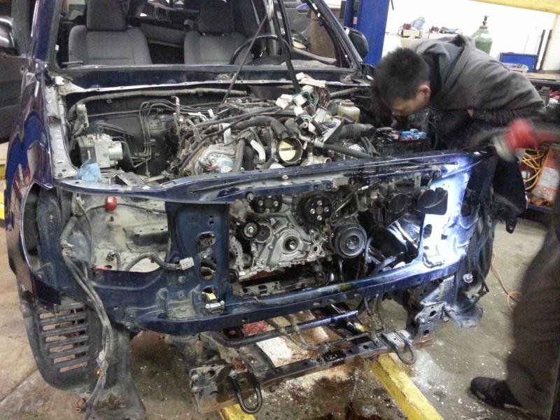

    Hello interwebs, Wang Lo Industries will be attempting the first ever ISF swap into a 07 Toyota Tacoma. No reason behind the build aside from the fact that we just happened to have an full ISF motor, trans, harness, etc. kicking around a shop. And broken 4 banger tacoma.
    We'll try our best to document the build incase someone is as crazy as us and would like to attempt the swap. Enough with the speal, here are some pics of our progress so far.
    Tacoma stripped down to it's bare bones

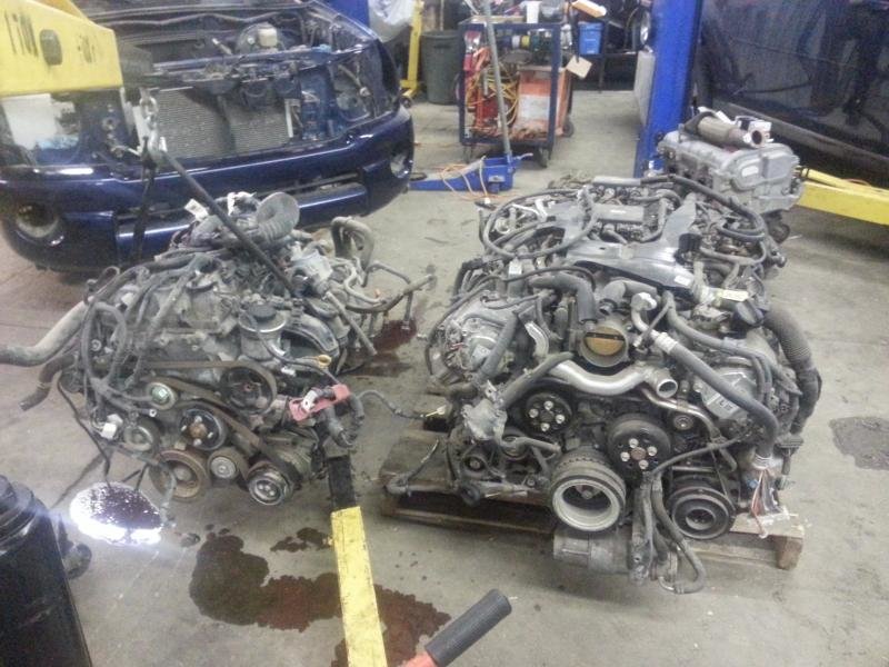

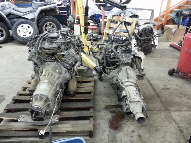

    Comparison of the two motors
    2TR-FE (2.7L 4 cylinder) vs 2UR-GSE (5.0L V8)

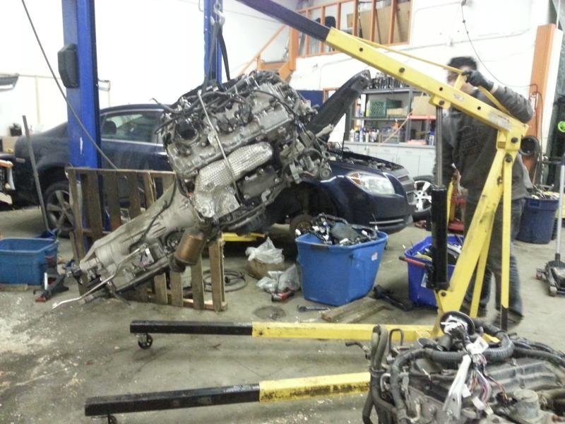

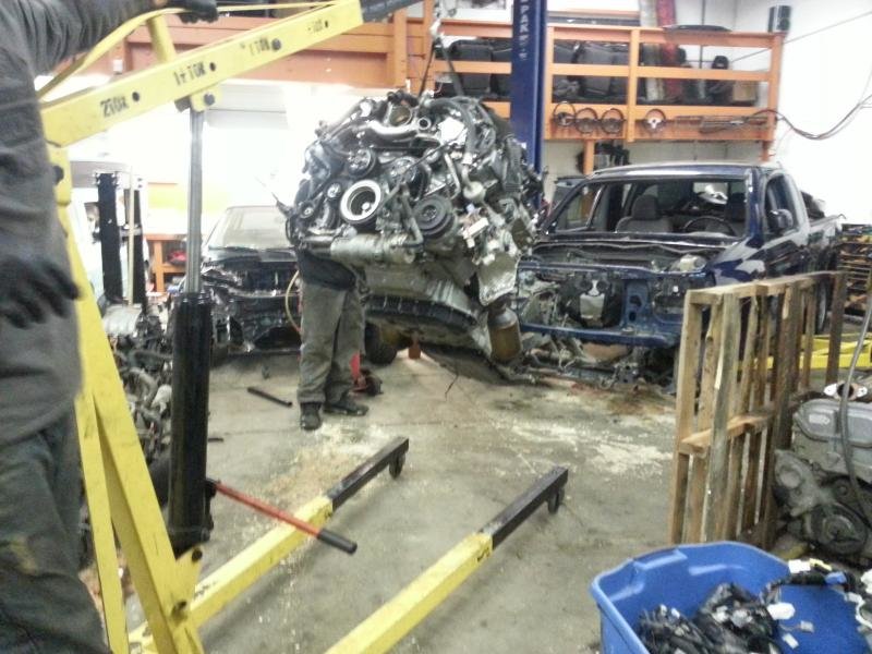

    Up on the engine hoist, attempting first mock up...

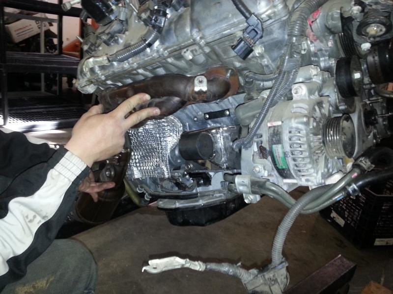

    Pabs making sure we don't crush the rad support.
    Frank checking clearances.

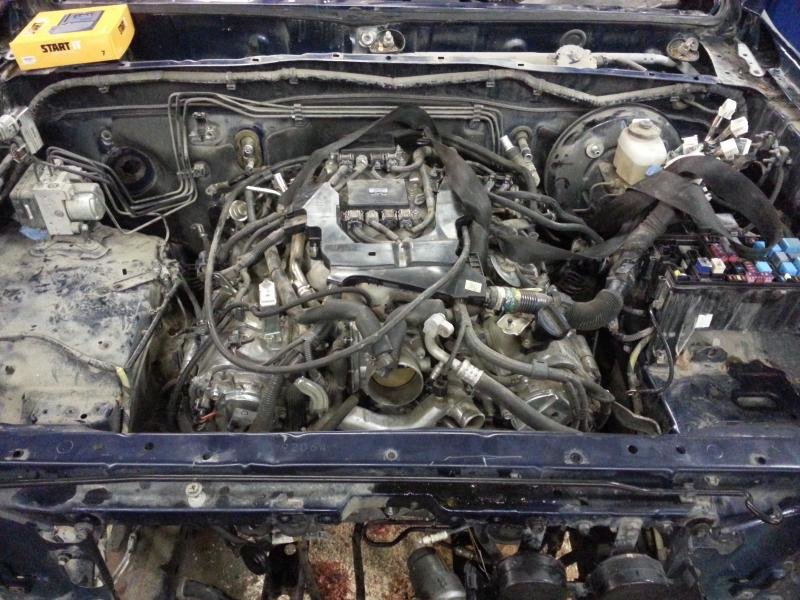

    Does it fit???? Yes...yes it does. I like what i'm seeing
    We're actually very suprised how well this motor fits in the truck. The motor mounts are scary close to the factory location. The plan is modify the factory mounts with some bracing utilizing the factory rubber mounts. The transmission looks like it needs a custom mount fabbed up, but that should be too big of an issue. Nonetheless, the motor clears the subframe, sway bar, steering rack, etc. It's like a match made in heaven. ANyways thats all the progress we've made today, we'll keep you in the loop with new updates when they come.

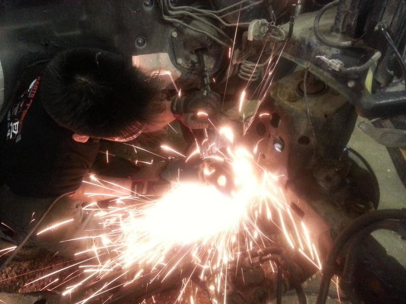

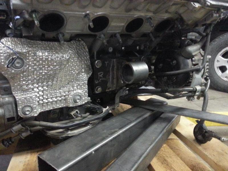

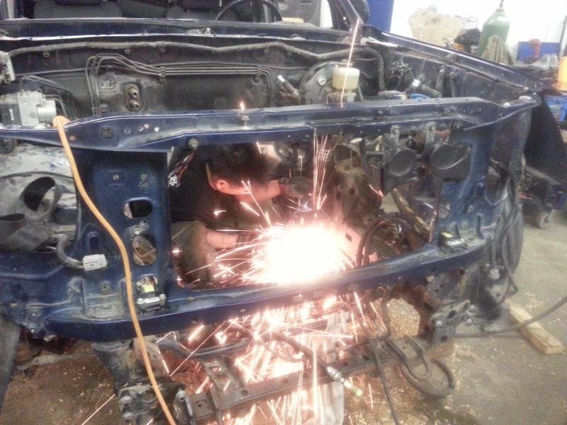

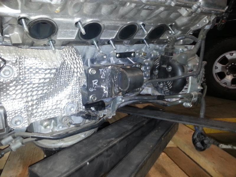

    Frank cutting out the OEM engine mount brackets off of the frame.

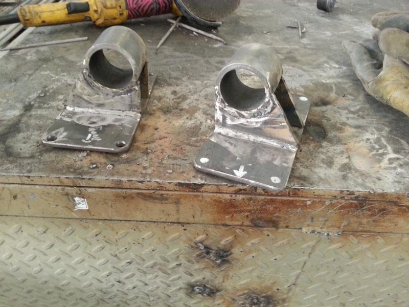

    Preliminary engine mounts
    Engine mounts mocked up

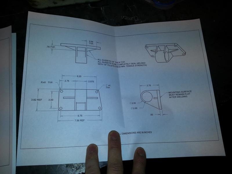

    CAD drawings for engine mounts (blueprints were sent out to the machine shop yesterday and should be complete by the end the week hopefully)

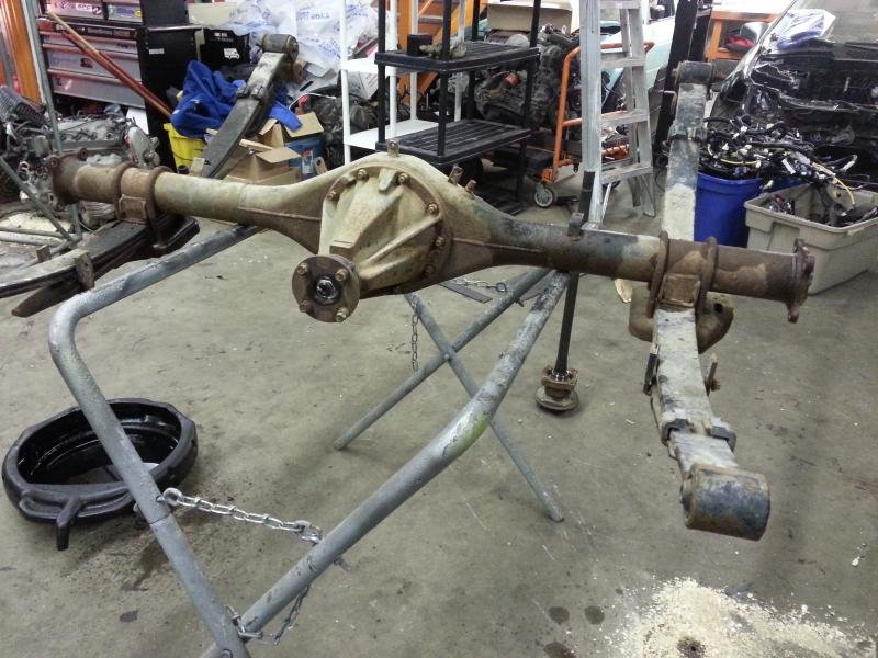

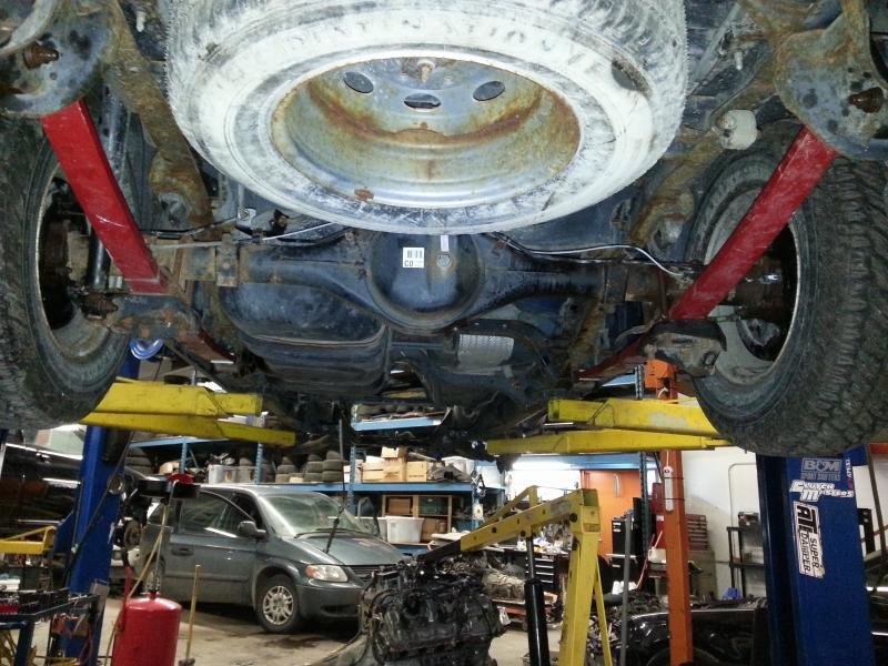

    Old rear axle/diff
    Swapped out for a Tacoma X-Runner LSD setup c/w TRD leafs
