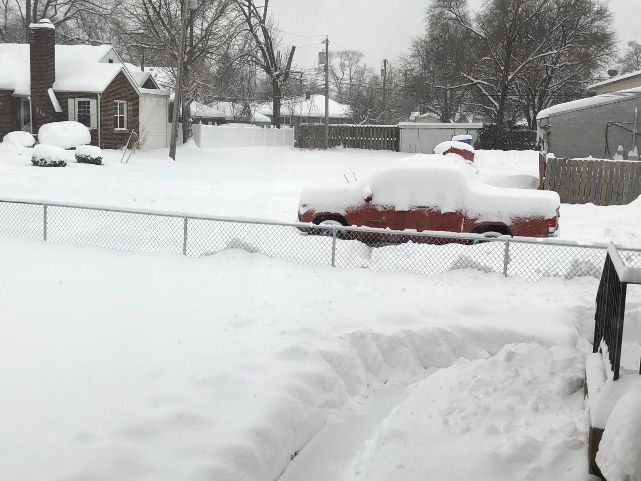

    I have owned my 09 pretunner trd sport package for 3.5 years. I bought it in CA with 6k miles and it’s treated me very well. I moved to OH where it snows 6 months out of the year and still am driving the same truck. I owe money on the truck which leaves me in a tricky position to just sell it and get a 4 wheel.
    Question is....
    Is there a kind of tire that may serve me a bit better? I had ATs on it already.
    I’m sure it’s exorbitant but what is the cost like to have an axel added and get this baby 4WD or AWD?
    Any other suggestion welcome as well. Obviously need the advice.
    Thanks

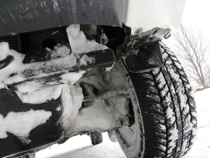

  8. Aug 16, 2018 at 5:33 PM
    Plain Jane Taco
    Plain Jane Taco Well-Known Member
    Apr 19, 2009
    #16179
    40,279
    USA
    This is what an undercarriage looks like after a 25 mile drive home from work in 15" of snow. No issues.

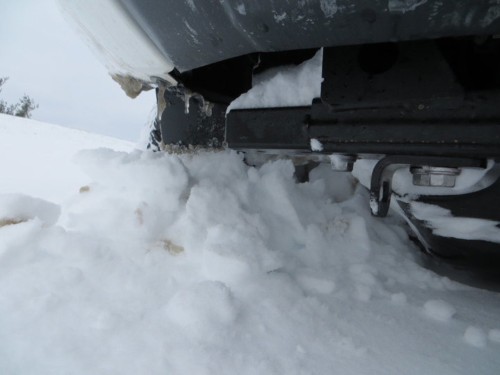

  9. Aug 16, 2018 at 5:34 PM
    Plain Jane Taco
    Apr 19, 2009
    #16179
    40,279
    USA
    Been buried to my skid more than once. Never got stuck.

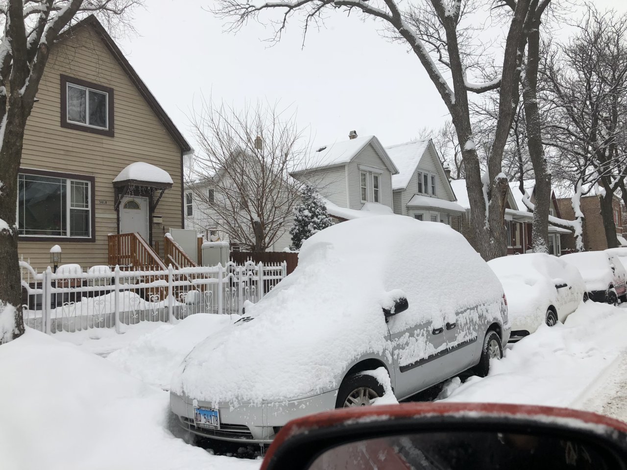

  16. Aug 22, 2018 at 2:28 PM
    #16
    kite_325
    kite_325 A simple human, being
    May 4, 2017
    #218142
    1,726
    North Carolina
    2017 TRDOR
    I would suggest some winter tires or at least ATs. But you should be fine regardless. I ran my 2wd turd gen hard this winter in Chicago with stock tires that were bald af.
    E3236BC4-0A27-4697-8172-4CD3811FC4B5.jpg 36FC55DC-163B-4F24-A82A-329235646B8E.jpg A4216195-67CE-425E-B6FF-1250F81022C0.jpg E5174F95-7DD7-4C65-948D-90BA96C0112C.jpg
