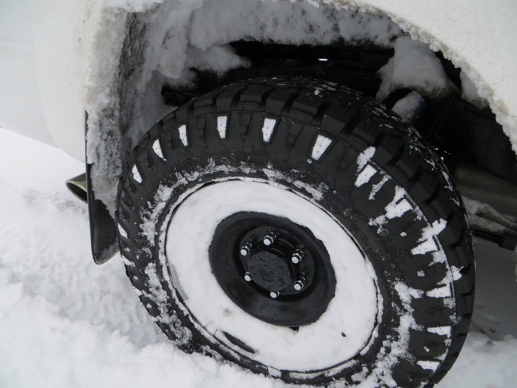

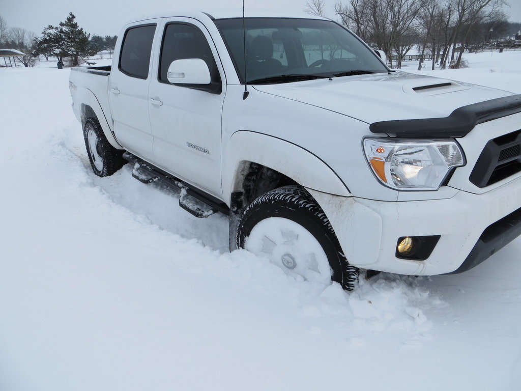

    I've owned both AT and snow tires. And I drive a PreRunner. So I can comment on the subject.
    It depends on your snow needs. If you're talking deeper snow, the Duratracs are every bit as good and in some cases better than dedicated snow tires.
    In more shallow stuff and/or compacted snow I would give the edge to the snow tires.
    I've had no issues running the DTs in deeper snow. Our last decent snow of 15" gave me no challenge. Plus the DTs have a much better wear rating than must snows. Either way...spend a few bucks and find yourself a cheap set of wheels to run in the winter. They don't have to be pretty.
