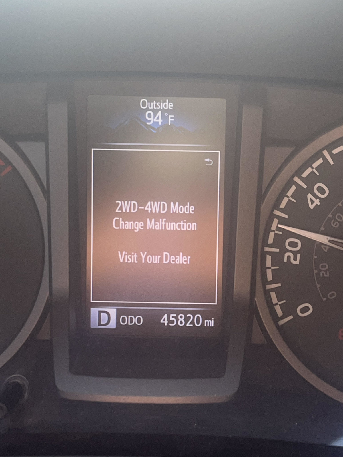

    Hey, I have a question for you guys. My 2020 trd off road tacoma is acting like it’s stuck in four-wheel-drive but there’s no power being sent to the front differential. I recently got my truck regeared 529s and the first time I went out to go break in the front diffs I put it in 4wd heard it click into, and the lights came on and dash. I took it to the dealership they said it’s the front diff actuator, the transfer case actuator, and the four-wheel-drive ECM. I got a cheap front diff actuator from Amazon connected it. It clicks in and out, and then throws the same code. Don’t know what else to do
