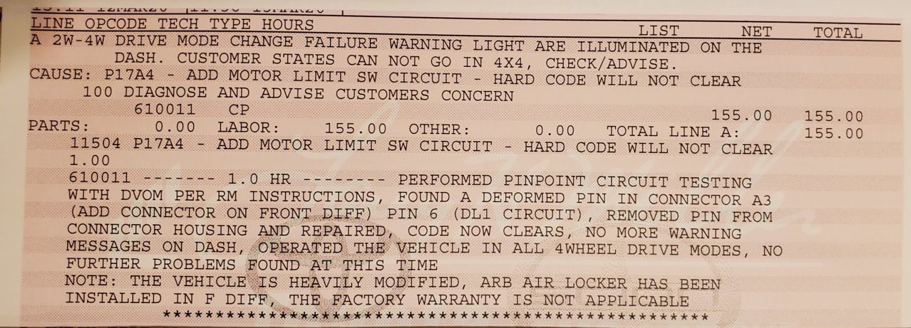

    Interesting. Bent pin?

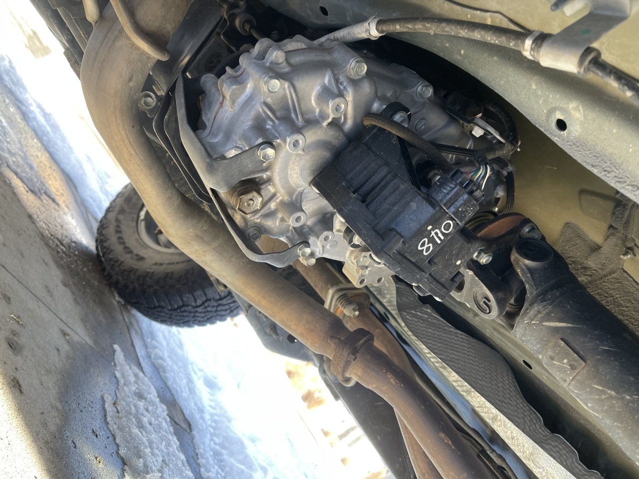

    Anyone got a photo of what I’m looking for? This same warning popped up on me today… ready to crawl under and have a look but no idea what I’m looking for…

    124CE7DF-C20D-4A35-A297-989B67B01DC1.jpg Give that black box a little tap tap tap

    Tap Tap Tap and I unplugged/dielectric greased/replugged that plug on top. Magic! Thanks so much for the assist!

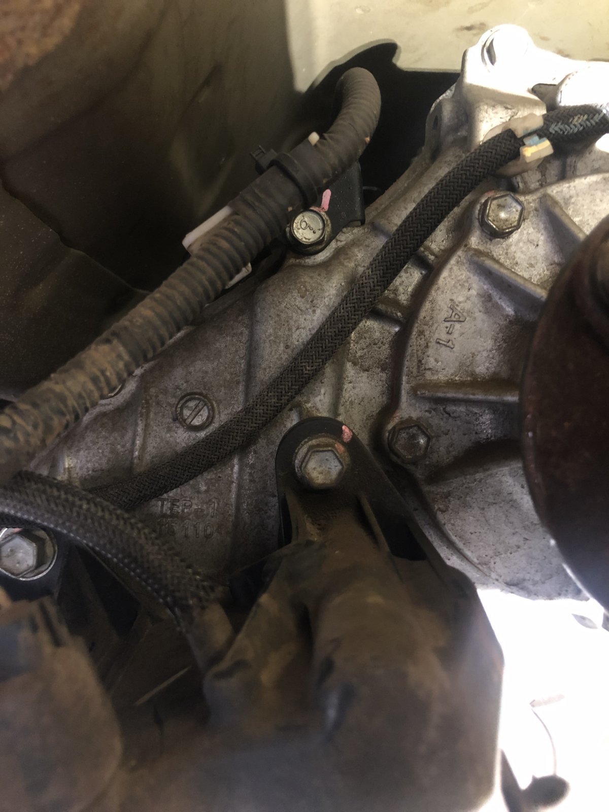

    This has been happening to me for a times now needing 4wd. So finally today went underneath and tapped the blk box a few times w a hammer and 4hi kicked right in!! The breather hose is a super bad connection, loose fit and my hose has two splits in it. So I’m sure it’s got corrosion inside the box as I’ve done numerous water crossings and we have super wet winters here. Crazy design, you would think it would be more water proof. Needs a hose clamp. I’ll post a pic up.

    183F9A31-6A5E-4A89-B171-79B70ECF7924.jpg 1BB99578-C1D4-4DA1-8769-87F4ED083C5A.jpg Hi All,4wd has been working,Used it a few times now.Forgot to follow up with the breather hose. 5 min fix just cut splits off hose and reattached.183F9A31-6A5E-4A89-B171-79B70ECF7924.jpg
