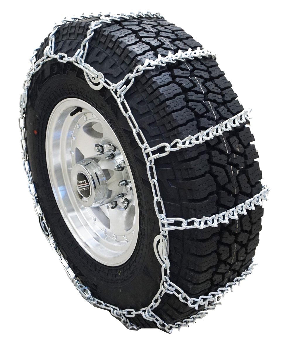

    get a set of these, and your 2wd will do awesome in any winter/mud condition (mind you still a 2wd) 2811CV-2.jpg
