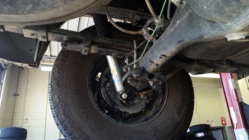

    ARE Shell. Pelfreybilt front bumper. hi-clearance rear bumper w/swing out. Rigid light bar/fog lights/reverse lights. Pelfreybilt front skid. Home/hand made slidders. DR front coilovers. Camburg UCA. AllPro Expedition leaf pack w/u-bolt flip and Timbren bump stops. 285 70-17 on stock rims with Spider Trax wheel spacers. EBC slotted/drilled rotors with green pads.
    Need longer rear shocks to achieve that droop

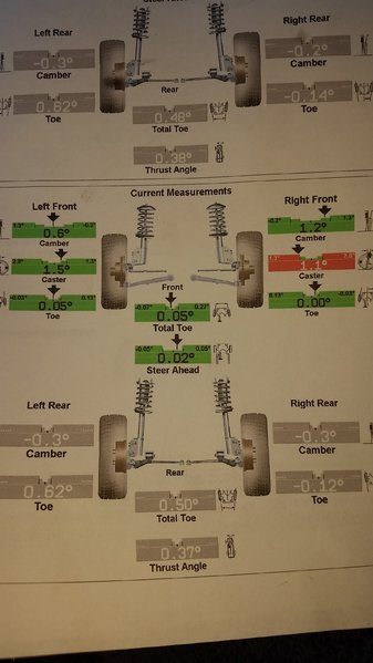

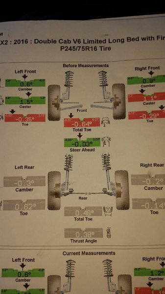

    Before and after

    Got mine done recently at a shop in Santee (San Diego) that specializes in lifted trucks. It was around $100 but they also had to adjust the rear axle which was slightly off (right wheel was further forward than left wheel). That was another $90. So almost $200 for the entire service. I'm going to Firestone for the lifetime alignment on Saturday.

    We shall see. The caster on passenger front is tightened as much as it can go, said I need to replace caster bolt??

    What are the proper spec's for a 2.5" lift with Total Chaos UCAs? I want to be able to tell them the proper spec's before they start so they do it right the first time.
