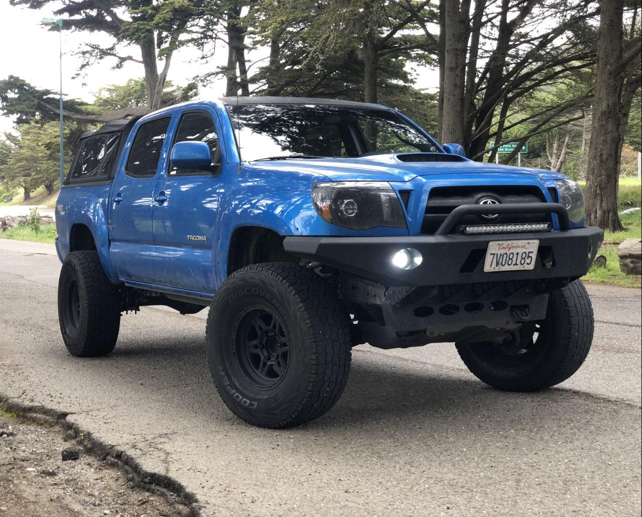

    Long time lurker, first time poster.
    Full time college student, so I took advantage of all the knowledge on here. Ultimately, decided I want my truck to look "meaner" than it is (its prerunner failings). but still do my best not to get stuck, WHILE on a budget. First time posting, so I apologize if the photos are massive.
    05' dbcb sb pre-runner
    TRD Sport
    Stock truck and had been on the oem suspension till about 2 year ago, when i decided to lift.
    here is how it turned out, with my takeaways from many thread searches.
    285/75/16
    295/75/16
    315/75/16

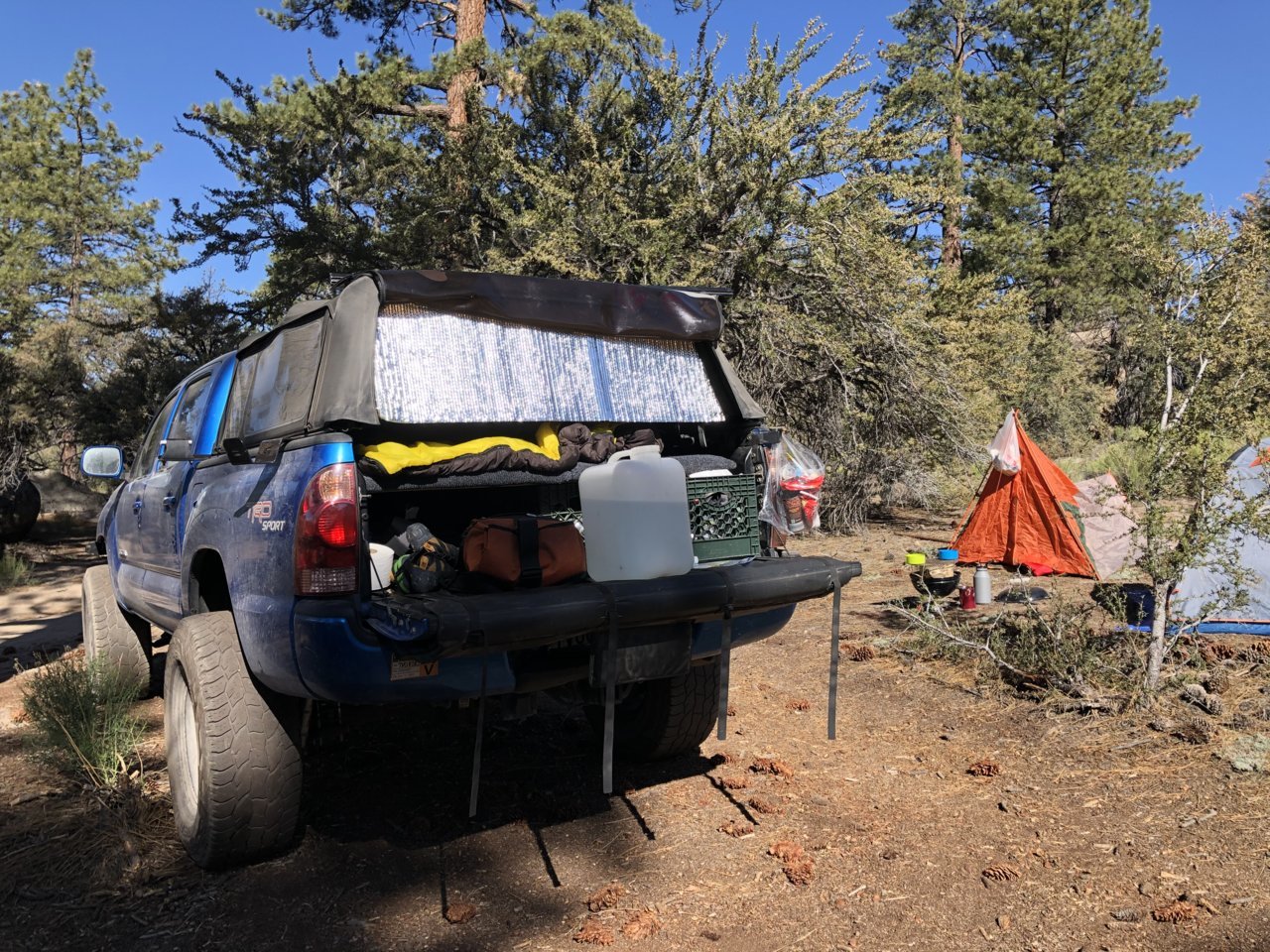

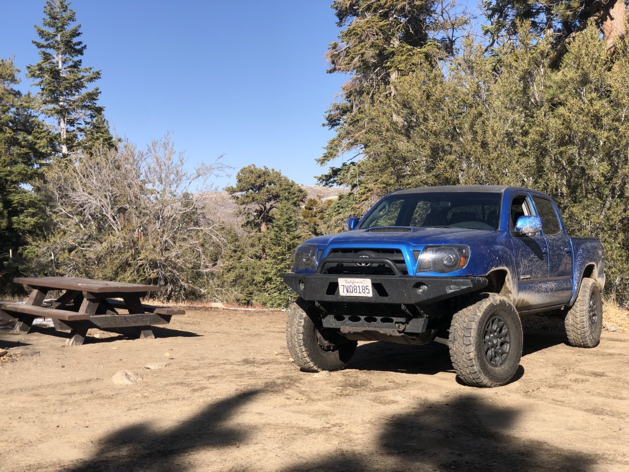

    This truck has taken me literally everywhere I've wanted with no problems. But I have experienced the short comings of a 2wd truck with an lsd. Either way, I can get most places I have no business being stuck. Took about 3 yrs to get to this point while being a full time student and working part-time/full time.
    milage ~289,000

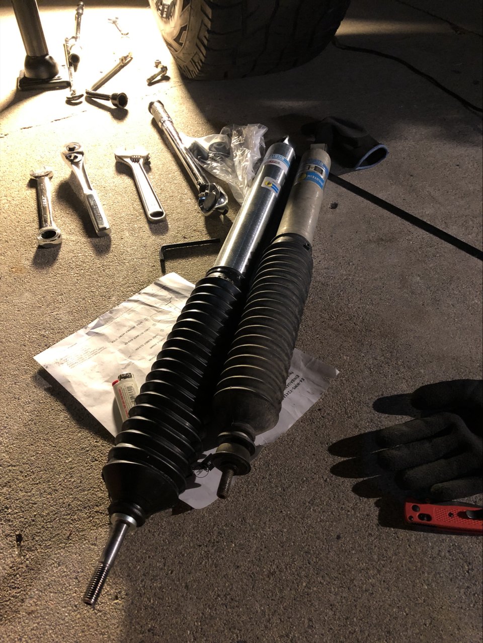

    - Bilstein 5100's x 4:removed
    -Front: Rancho RS9000XL
    -Rear: Bilstein B110 Extended Length

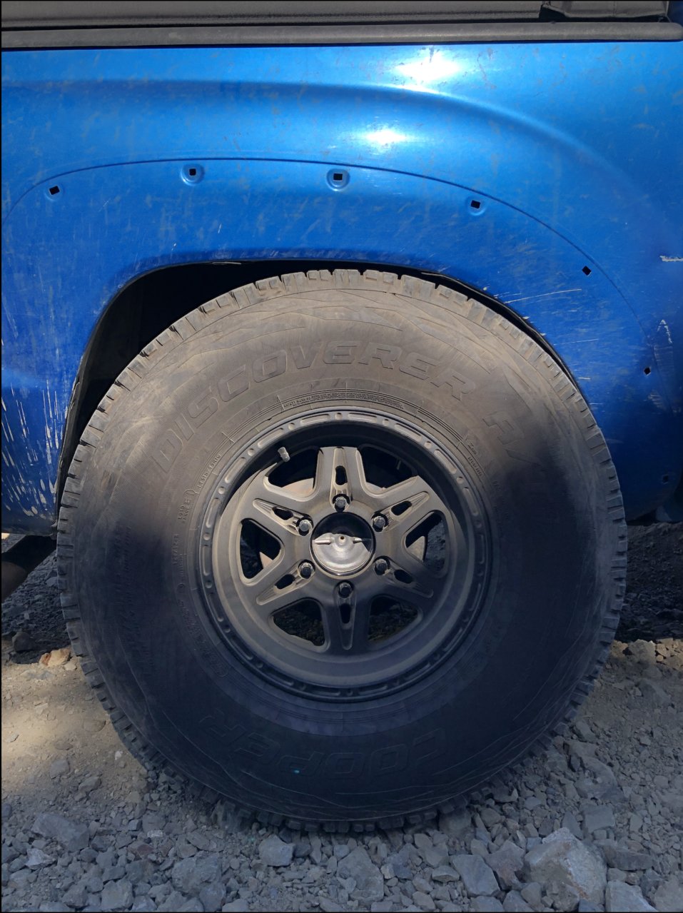

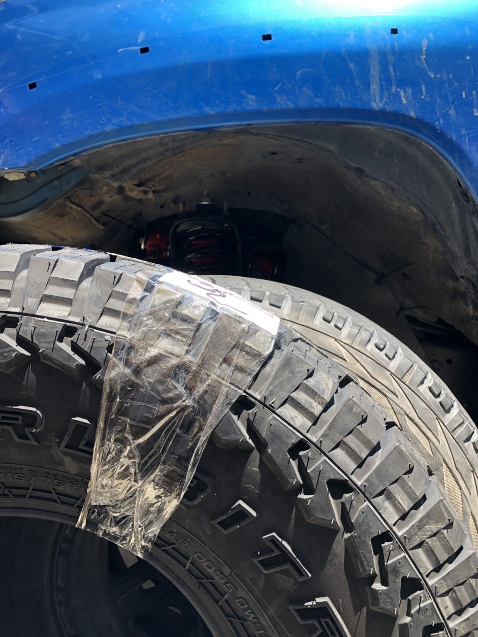

    I came across a post on offer up and ended up with some used 35's.
    A set of renegade wheels on some Cooper All terrains.
    They "cleared" for pavement driving and didn't rub lock to lock on flat ground. But otherwise, I could hear them rubbing up driveways, over speed bumps, etc. as to be expected.

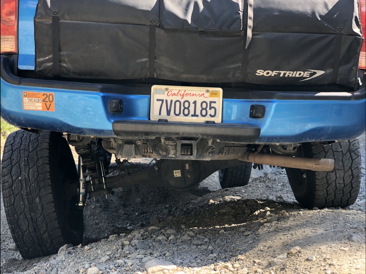

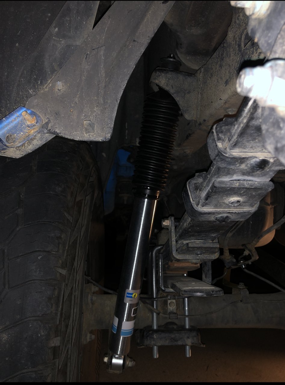

    These wheels are heavy and I could feel it in the suspension. I had about 3"+ of rear lift on stock length 5100's and they were definitely topping out.
    Extended length 5100's fit well and the bump stop didn't need shimming.
    Immediately went out to see MOar FleX BrO!
    And also realizing how much I'll be needing to trim.
    The front end was topping out noticeably if I went too quickly over speed bumps and I could hear my "self adjusting alignment" (lower control arm bushings worn). Alignments wouldn't hold with the 35's, but these are the stock lca with 300k miles on them.

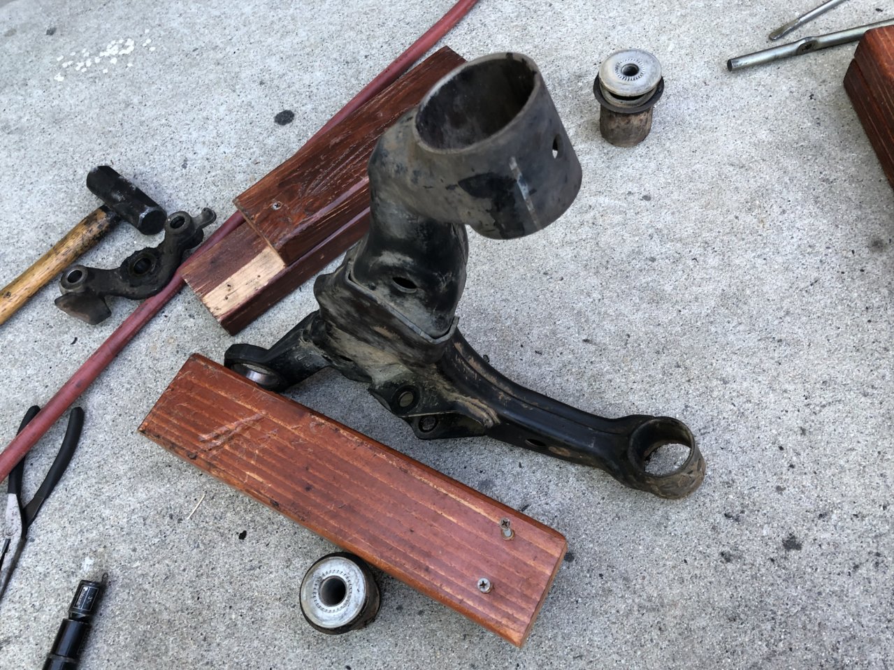

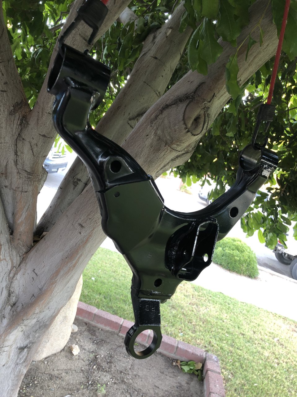

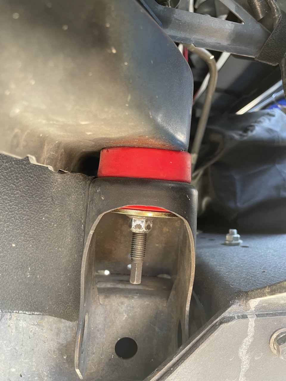

    I did some reading and it looked like it would be worth saving the time and replacing the whole lower arms with a Moog or OEM replacement.
    So I got a shop press to install some Whiteline lower control arm bushings and some Mevotech TTX Lower Ball joints.
    Used the press to get the old ball joint out and the torch + bottle jack worked perfectly on all 4 bushings.
    Got the passenger arm cleaned up and painted, going to finish the drivers side and press everything back in today.

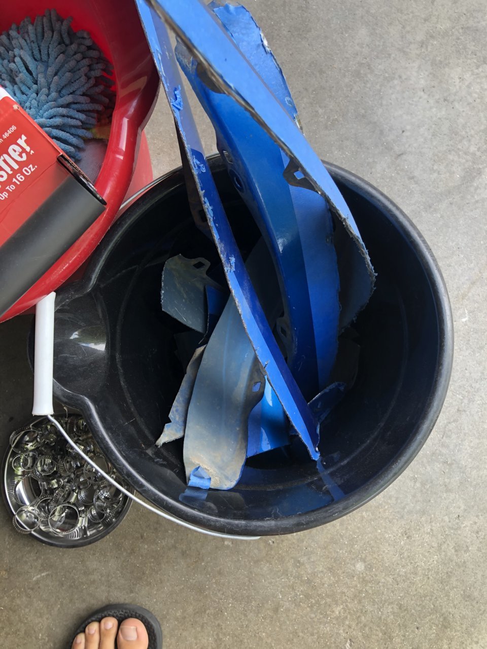

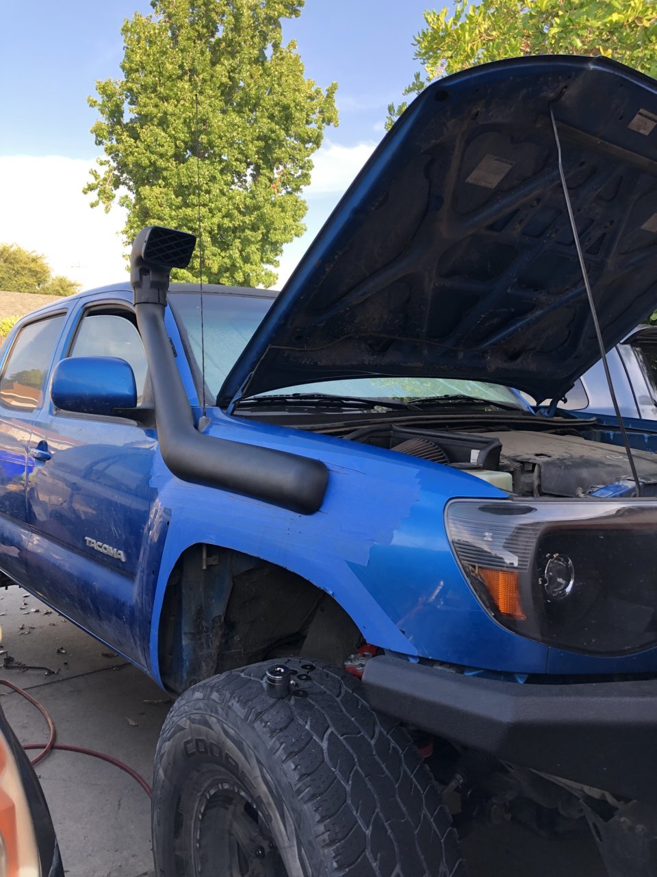

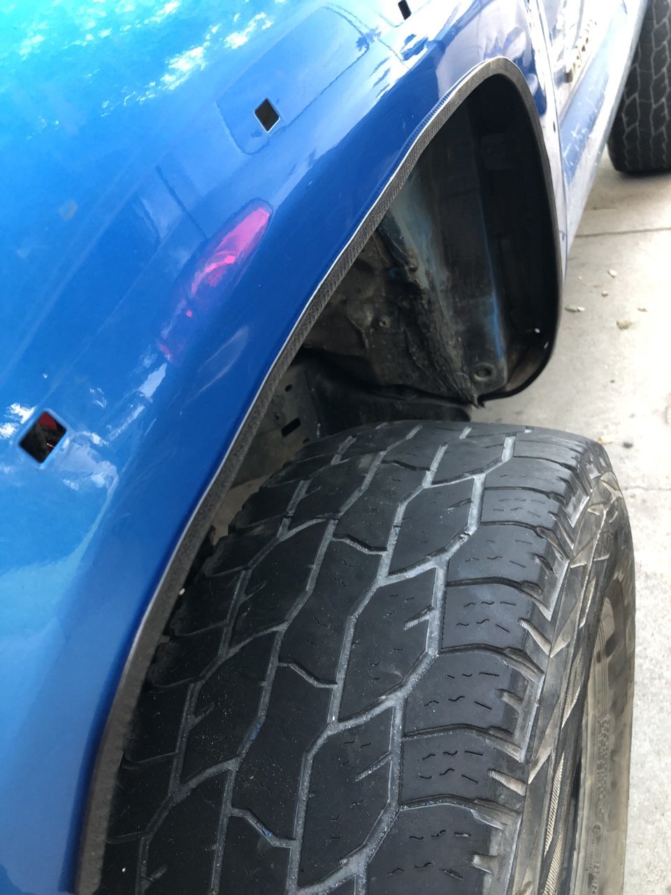

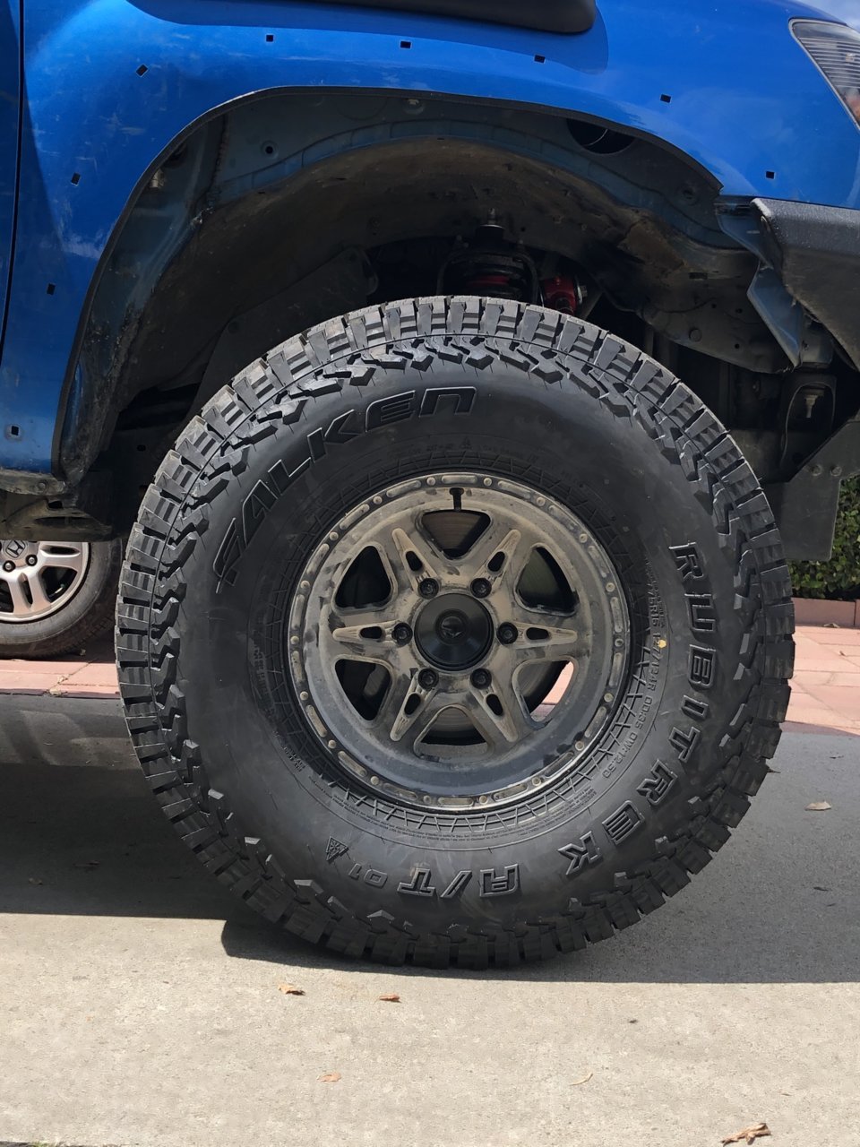

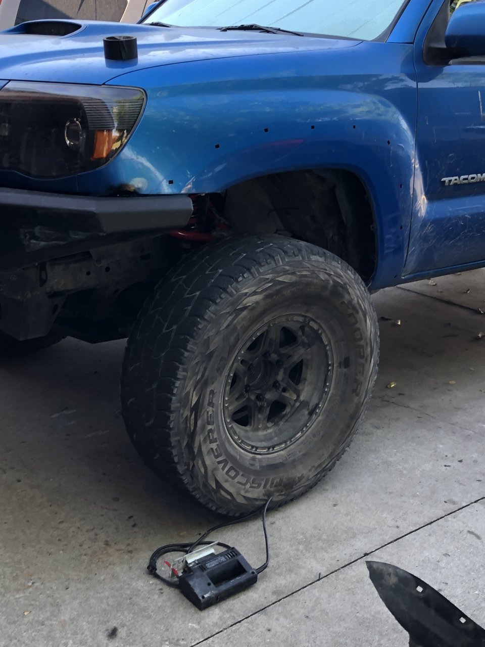

    new shoes came in, so it was time to trim. which also meant, no wheel liners.
    91636BFD-DBBF-4DEA-818A-A393D159E75D.jpg D77A2831-C0EB-4C7A-AEFE-107D5A60441C.jpg A4730D04-8D27-4C6D-8884-AA6C6971C47A.jpg

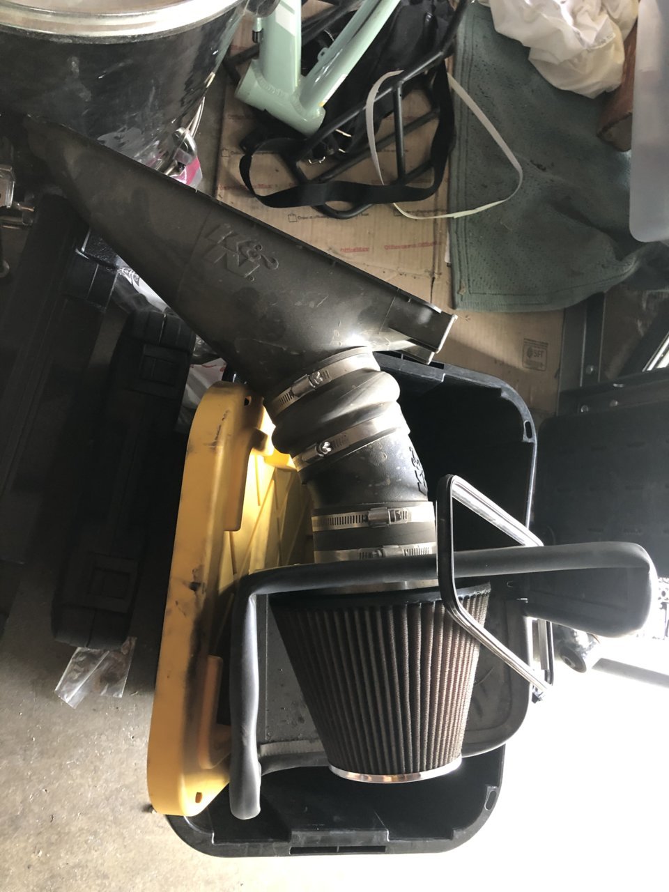

    replaced the K&N cold air intake with an ebay snorkel. i was surprised with the thickness of the plastic. seems solid.

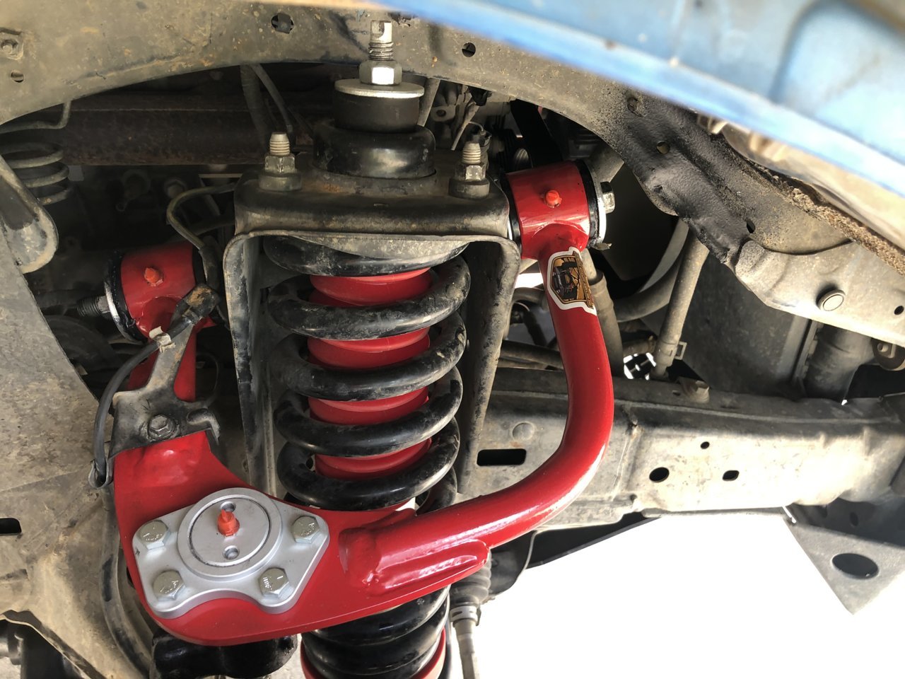

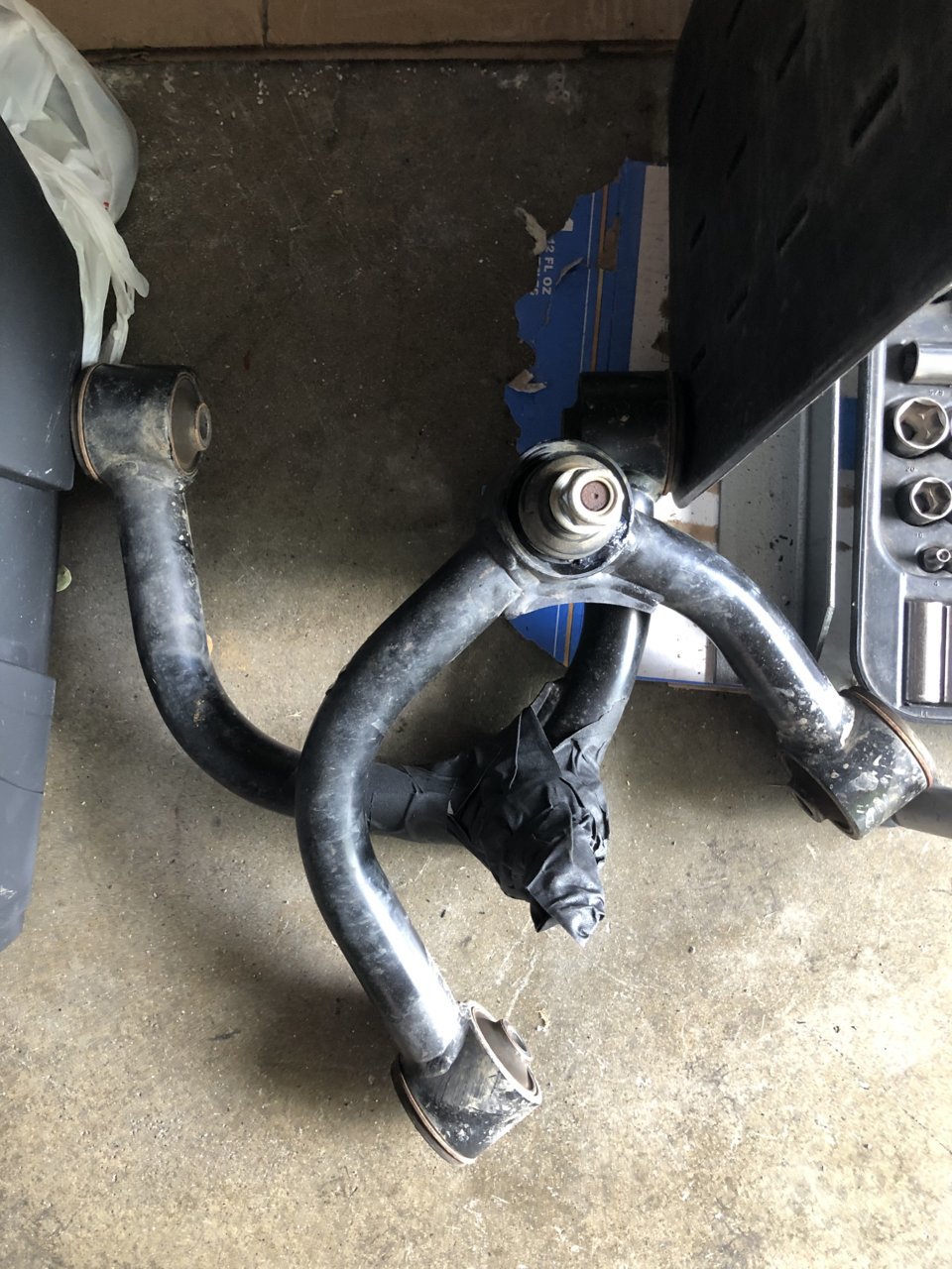

    it also made sense to replace the uca with something that would get me proper caster numbers at the shop. so out with the Freedom Offroad Arms and in with some JBA Std’s!
    2C931210-0DF5-4923-B378-D76634D72160.jpg 6D09828E-10B4-43B1-B438-212FFBFD09F1.jpg
    threw some trail toys edge trim and done. the new rubber Falken Rubitrek 315/75/16.

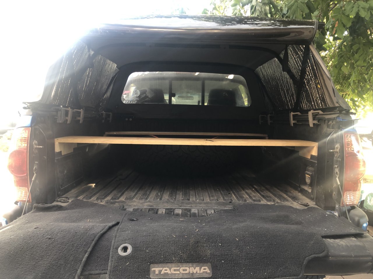

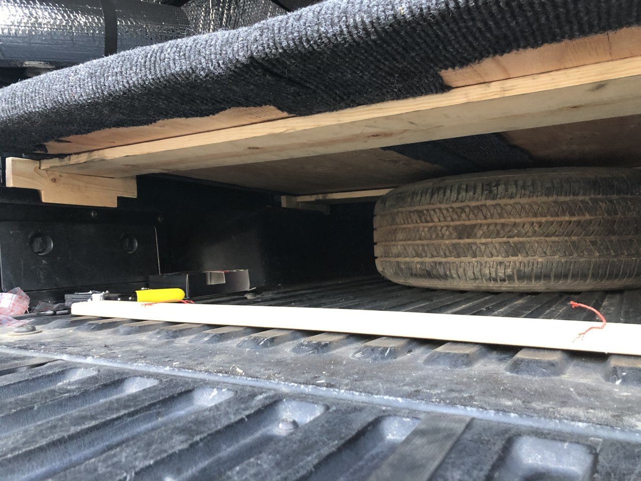

    Needed to carry a spare in the bed of the truck.
    Kept the 17” spare steelie and mounted a Kenda Klever 35x10.5x17
    This saved a couple inches in head space over the 315/75/16 counterpart.
    OEM spare on the 17” and spacers placed under cross supports of sleeping platform.
    Kenda Klever fit under the cross supports with about 1/4” to spare. Tied down the spare with a strap on some added D-rings.
    with the spacers under the cross supports, milk crates fit perfectly under the sleeping platform. Tire acts as support for front cross bar and crates for the rear of the platform.
    This platform has worked well over a year, but I do miss having more head space ( before the spare was under the platform).

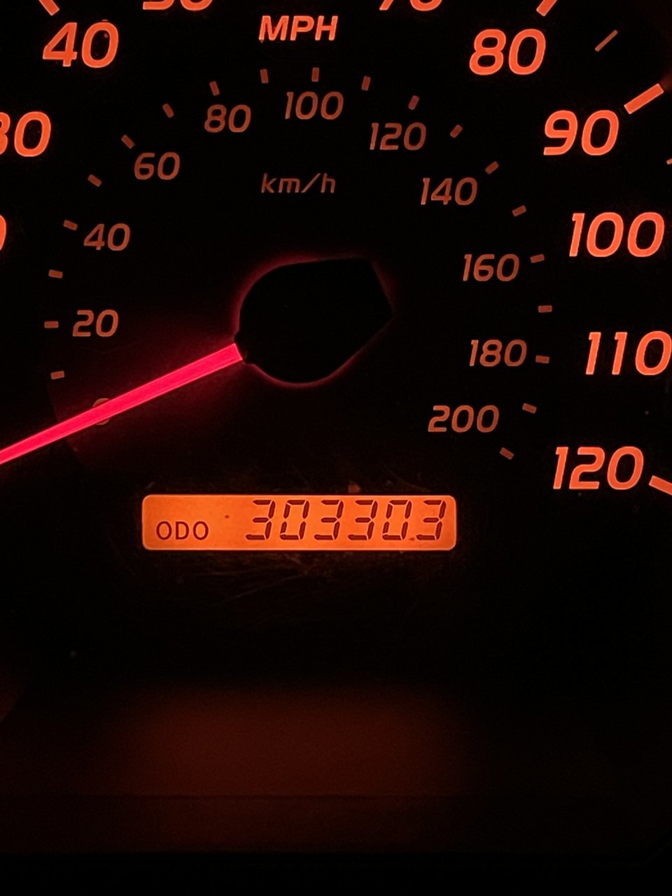

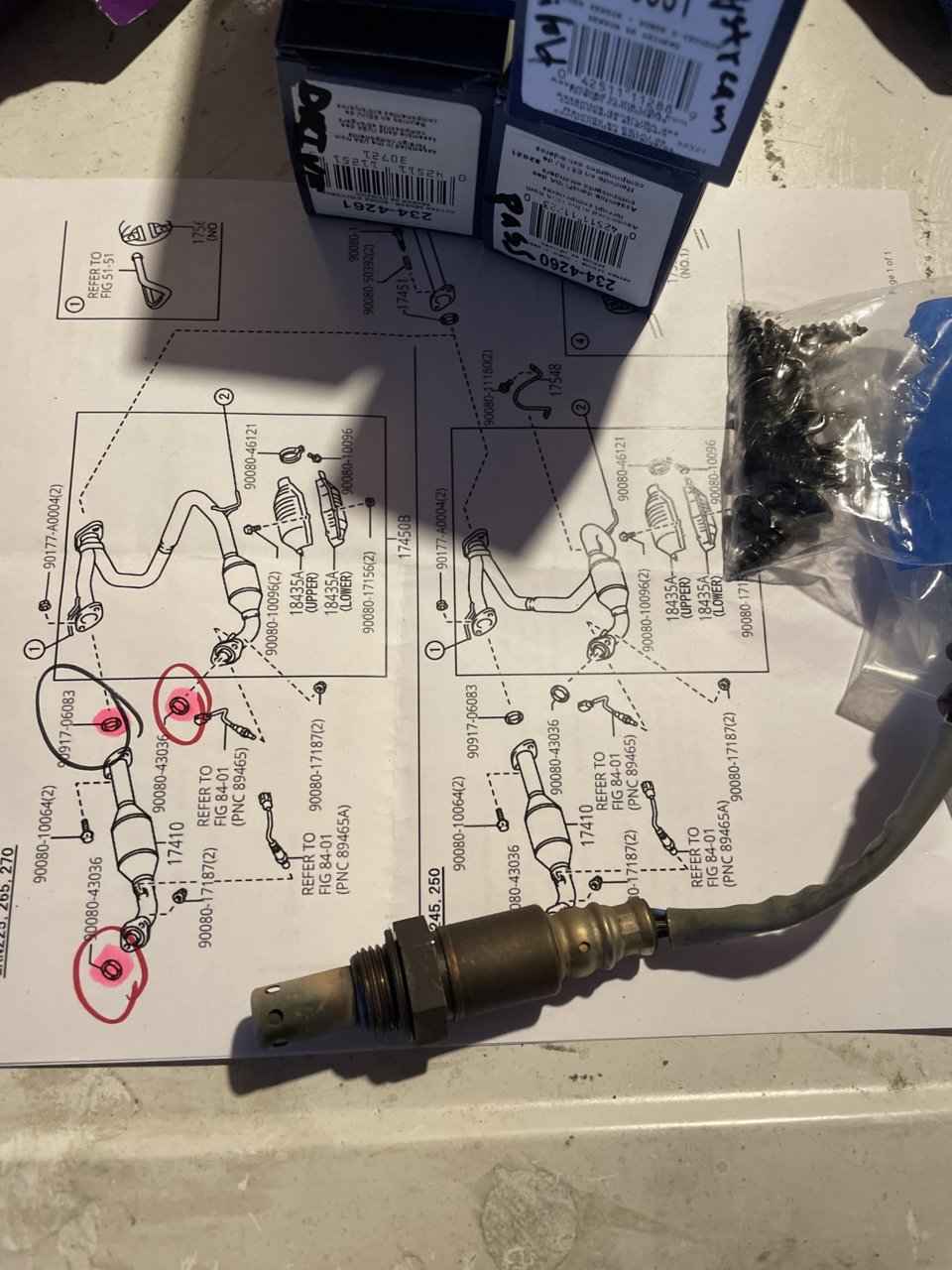

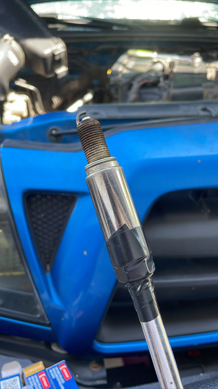

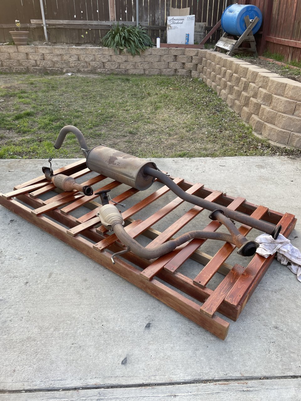

    small update. shortly after the 300k
    milestone.
    I got codes P0402 and P0403. Tried swapping 02 sensors (upstream and downstream) and the issue persisted.
    Pulled the second set of cats (not attached to the exhaust manifolds) and replaced.
    all good since and the truck gets better mpg.

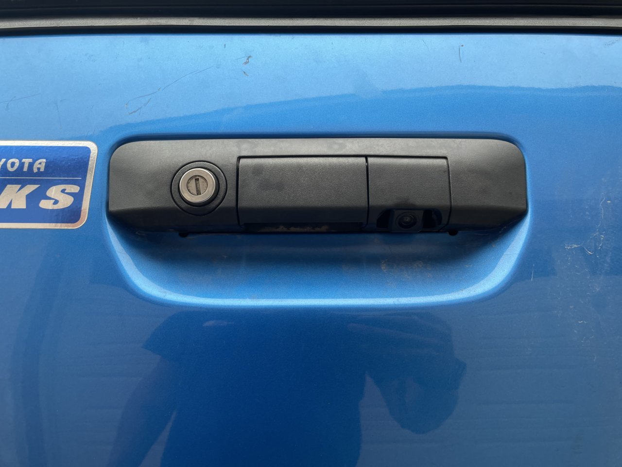

    after a few years with the camper and poor rear view visibility. I got an android head unit and wired in front and rear cameras. and added a manual locking pop and lock.
    145B4444-138C-46F9-A47E-30D37FF4AF43.jpg 35C6DC2E-F5A7-4811-979E-6DFA5B309829.jpg B4B6D953-3E33-4678-837D-FBB63B84C3A5.jpg
    Thanks to the forums, i was also able to wire my own anytime back up camera switch too!

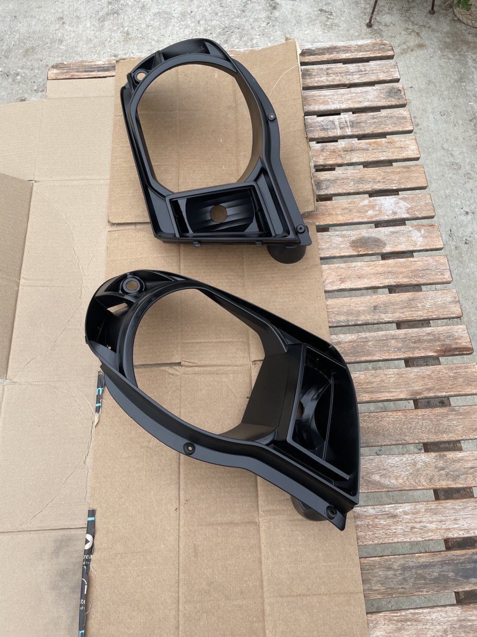

    I got rid of the crappy depo “projector” headlights and did a bhlm and ulmtimate headlight upgrade. significantly improving visibility.

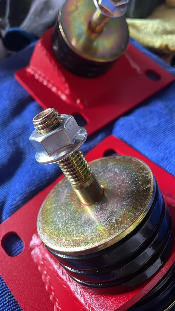

    I was getting a lot of play and clunk going on in the front end. Found my radiator bushing were blown out, swapped for some energy suspension poly bushings and what a difference.
    Still had some clunking and play. Especially on hard acceleration from a stop or getting back on the gas. Decided to try some PRG poly motor mounts. Also did spark plugs to see if that would help with vibes.
    4E7A40BD-31D6-46FF-B530-B380687B1699.jpg 24EEEB26-3A77-4E6B-8BD8-F0F8E93A1964.jpg
    The new motor mounts helped fix some driveline vibes and got rid of slop in the drivetrain. There was quiet a bit of movement that I thought was axle wrap, but it seems like it was the motor mounts. Truck is way more responsive and accelerates quicker (even on stock gears and 35s) but vibrations at idle are significant. overall worth the trade off to me. of course this is all subjective.
