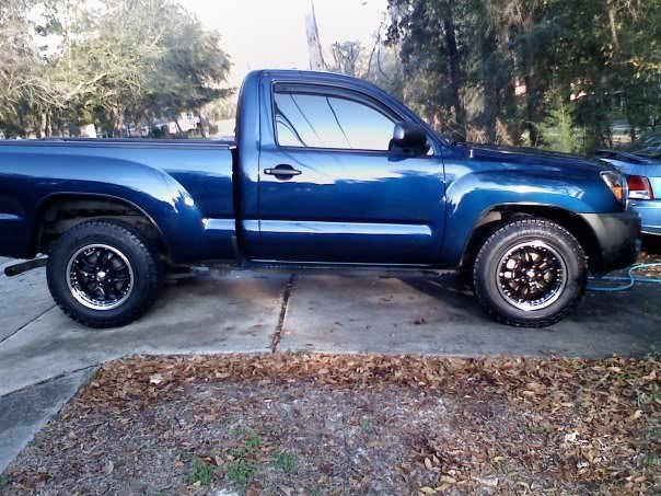

    You mean like this ? These are my wheels...
    Hmmmmm, kinda harsh words...but what a lot of people don't understand, at least from my experiences, is that when it comes to 5-lugs, there aren't really a whole lot of options for wheels. On my 08, the offset for the wheels had to be crazy positive to clear the caliper on the front brakes. I really wanted a negative offset wheel and a wheel with the "deep-dish" look to it, but they're really hard to find for the 5-lug. :(
    I running a 225/70/16 and I plan on going up to a 31inch tire once I've got my lift on, but first I need to add some power to even get it moving. It's a tough world for us 5 lugs when it comes to modding or upgrading wheels and tires, but they're out there...you just gotta look for them. Just my .02. Good luck!

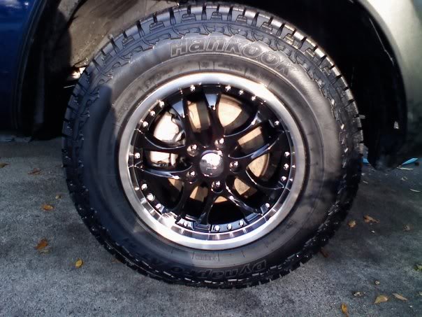

    Pioneer AVH-p2300DVD, 12" Memphis sub and Alpine MRP-M650 amp, 32" BFG AT tires and KMC wheels, tinted windows, satoshi grille w/ stainless steel mesh, Avid front & rear tube bumpers, Cobra wx75 CB with 3' firestik, GaragePro bucket seats, FlowMaster 40 series, aFe CAI, Black head lights, LoJack and Autopage alarm installed, Avid sliders.
    I have 30x9.5x15 on mine. :) my spedometer says I'm going a little slower than I really am. :)

    Nice looking Taco man. What wheels are those and what's the offset ? I'm looking for a set like those.
