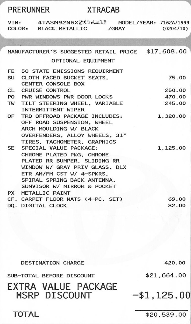

    Negative. The 2.7l auto Prerunner with TRD package was the redheaded stepchild of the bunch. At least it was in '99. Inexplicably, only that one did not get the locker, just a plain old open diff with a (I think) 4.56 gear.
