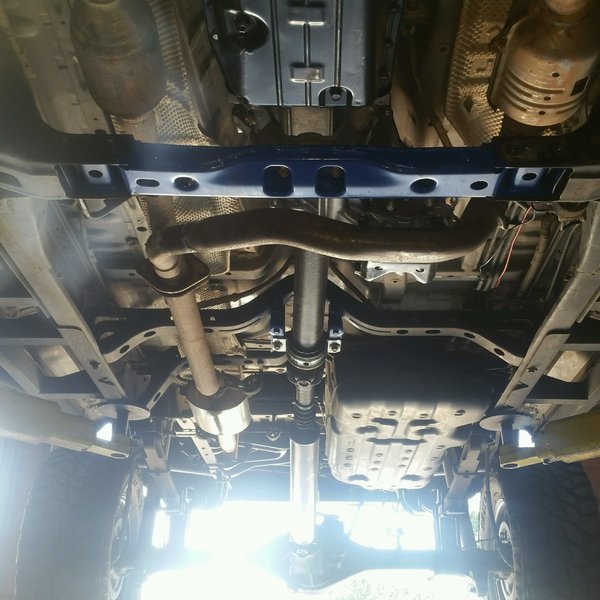

    Rear full long travel including upper and lower rear control arms. 37s Mickey Thompson Baja boss MT,
    just some pics
    and stock trans

    Will do. My plan is to buy a beater car while I tear into my truck or at least pay somebody to tear into it. I'm no mechanic, but very good with my hands. I can fix anything on my truck except engine / transmission basically. Mainly due to no workspace & lack of tools. Engine hoist, etc.

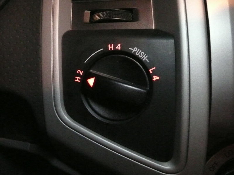

    Is there anyway to avoid the J shifter 4x4 cutout on the interior & use the dial type vacuum switch regularly OEM to switch to 4x4?

    I think it's called the ADD system
  6. Jan 23, 2017 at 10:09 AM
    #26
    Squatcher
    Squatcher [OP] Well-Known Member
    Apr 1, 2013
    #101045
    276
    Dean
    California
    Speedway Blue "Genie"
    Blacked Out Hood Scoop, Cherry Bomb Extreme Muffler, Line Out Converter/8 inch Sub, GTA Car Kit, Plasti-Dipped Logos & Rims, Rubbermaid Splash Guard, Lightweight Battery, Fitch Fuel Catalyst, K&N Drop in Air Filter, Flex a Lite Fan w/Thermostat, HIDs, LED License Plate Lights, etc. 4x4
    This guy:
  7. Jan 23, 2017 at 10:10 AM
    #27
    ahspurlock
    ahspurlock The TW Mechanic
    Oct 29, 2014
    #141311
    19,043
    Adam
    summerville.south Carolina
    08 T4R V8 Limited AWD on 37s
    no you'll have to have a stick of some sort for the tcase
    the ADD is whats on the front diff

    no you would need a 4wd computer for that
