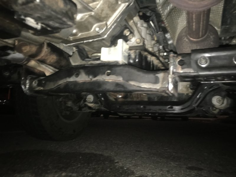

    Yes, I am aware of what modifications are needed. Here is an example of a modified crossmember from @ajohnson build. I think he started with a 4wd crossmember but is this necessary? Does the 2WD transmission mount have the same crossmember bolt pattern as the 4WD? Can you just cut out the center section and ends of the 2WD crossmember and use rectangular steel?

    What hasn't been modified?
    Yes, that's what rst did when they converted. Cut up the 2wd mount and used some 1x3 box tube to make it fit.
    Another option I had a 4wd mount and cut it then lowered it till it was the height we wanted IMG_2713.jpg

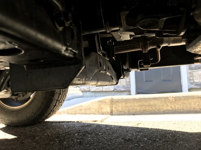

    jowybyo
    jowybyo Well-Known Member
    Nov 19, 2013
    #116863
    6,092
    Joe
    Baltimore, MD
    '14 MGM DCSB Postrunner 4wd Conversion, Debadged
    Yours looks almost just like what I did.
