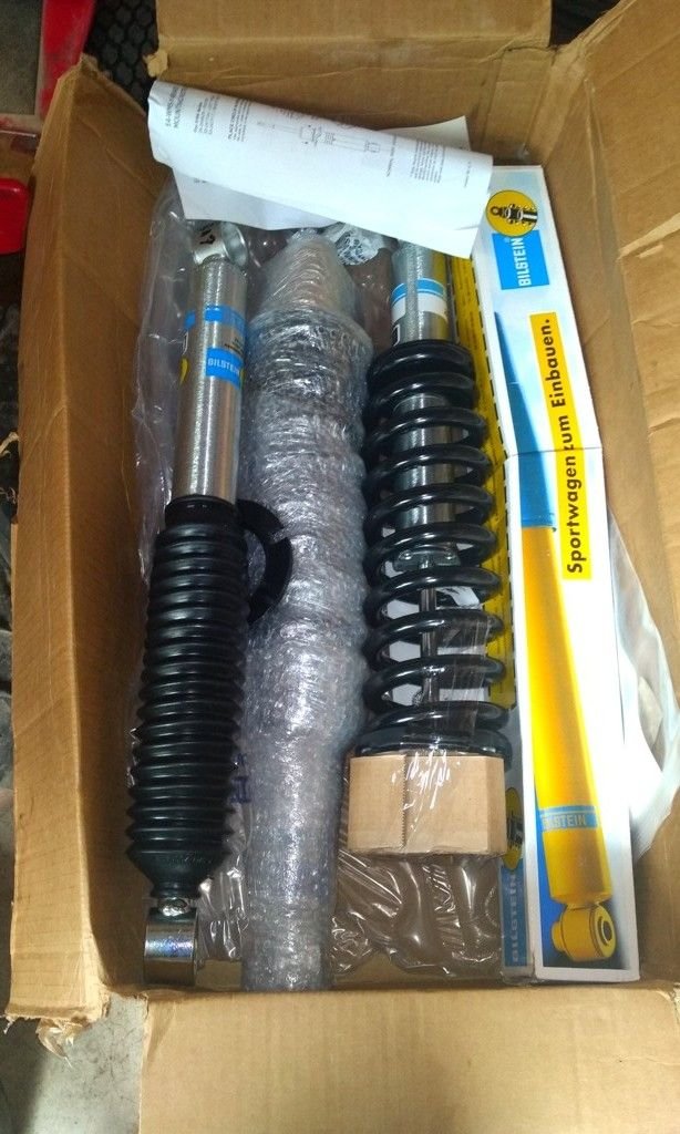

    I called Wheelers and talked to a suspension consultant about what I wanted and they fixed me up with a pre-built 5100 OME 880 package. There is a Tacoma world discount that you need to ask for when you talk to them. It was a good move because everything was ready to install when I opened the box.
    I've read that 4600s and 5100s have the same valving. The 5100s allow lift adjustment and have a longer stroke for the rear. We run factory 4600s on the Frontier and no complaints. Both are great shocks. Just slightly different applications. There is a spacer that Wheelers sells for the driver side to help correct the Taco lean that is worth looking into.

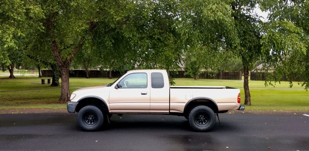

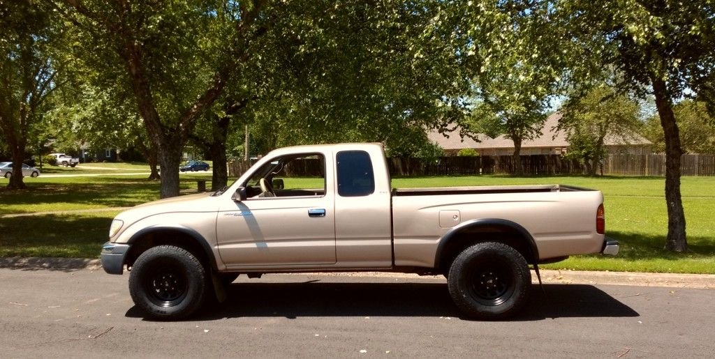

  19. Sep 7, 2019 at 6:06 PM
    #19
    CS_AR
    CS_AR Well-Known Member
    Apr 3, 2019
    #289019
    12,923
    1999 Tacoma PreRunner TRD
    Everything but the driveshaft. B03A - 410
    Before with stock springs
    After 880s
    I would like to freshen up the rear springs to level it out with the front. So maybe some spring addition that will give no more than a 1.5" lift.
