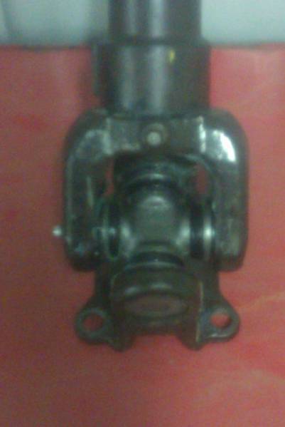

    There is a hole that allows the old grease to flow out, it must be plugged. Sealed units are not completely full of grease, maybe 60%...

    I would tell you what has a hole :D
    but I am curios about your magic hole so please find a pic in FSM and post here ...
    Grease to flow out ?? WHere it supposed to flow out ?? You have two pics of u-joints do you see any holes there ? I am too lazy to make pics of my spare joints
    Dont tell me you are talking about channels inside the u-joint :D is that what you call hole??

    U-joint caps are pressed into the yoke if you doing by yourself you can use that [​IMG]
    to press old ones out and new ones in Dont remember if new ds has locking tabs (I assume they have) you should reuse old ones as they usually spaced to balance the shaft
