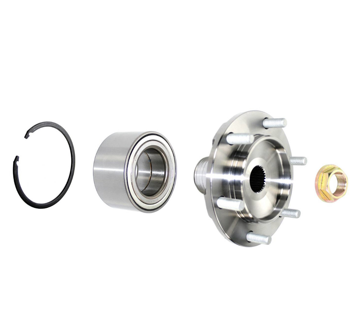

    It’s not a simple bolt on piece & the bearing is a cartridge style bearing. you have to press the bearing cartridge out of the spindle as well as press the hub flange from the bearing.
    I can provide you with the parts, a puller is available to rent at any auto parts store.
    Assembly is straight forward, no press needed.
    I have everything you need for the job.

    What your showing him is 6 lug....
    .....5 lug is completely different........

    It’s a generic picture, the 6 lug does not use a cartridge type bearing, it uses a tapered bearing that bolts to the spindle.
    I’ve been working on Toyotas for 24 years.
