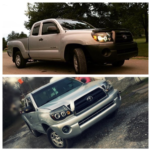

    2006 Toyota Tacoma 2wd Access Cab
    So far Led lights. Soon 3 inch Lift , Mud tires , dauls, fender flares
    The top was my before , bottom is after. Putting fender flares and 3inch lift next!
