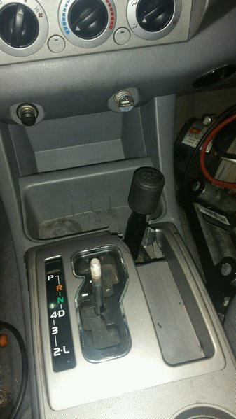

    hey peoples, soon i am goin to convert my 2014 into 4x4 so i can reall start having some fun. done the research, and its looking like a bit over 2k to do it, so why not. and for all you "just buy a 4x4' folks, i am not in a position to do so, so i dont wanna hear it. so far ive tracked down the tranny, driveshaft, and transfercase. still looking for the axles, and other than that im not sure what else ill need, so heres me asking anyone for any advice. thank you

    youll also need some sort of locking hubs and youll have to relocate a crossmember as the 4x2 and 4x4 crossmember by the tranny are in different locations

    you will need to contact rocksolidtoys for a ADD switch and a front diff from a 05-15 tacoma or fj cruise 4runner . 4wd hub and bearings

    perfect, i wonder how much 1st gens and 2nd gens differ because you got alot of good pics

    you can use a stock 4wd crossmember we just moded it to fit

    Check into 4th gen 4Runner parts, that's what I'm using to do mine. All parts ~1k and then have to modify cross member

    to much none of the parts will work from a 1gen
