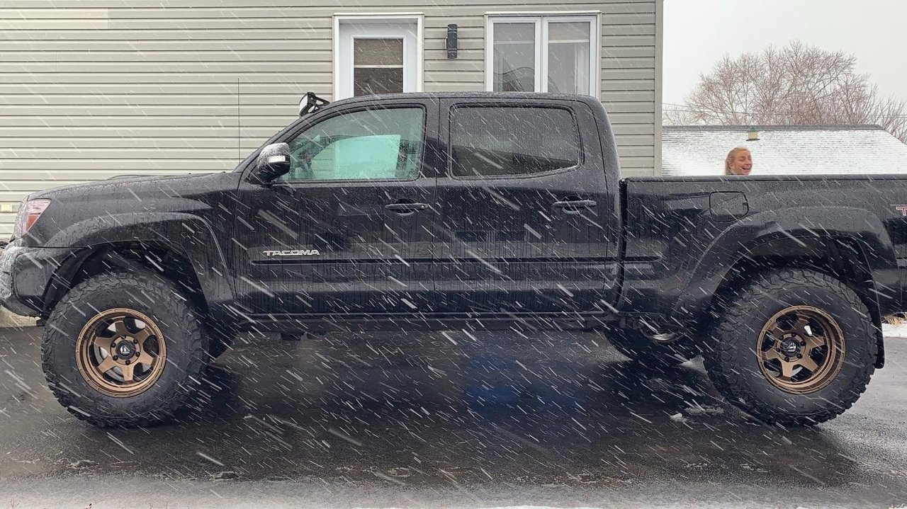

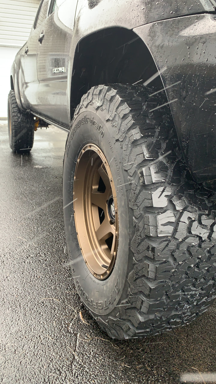

    1C852AE2-ED0C-4570-9949-4C48DA4FCDF7.jpg 451807EA-3F83-4FD5-8E48-53C9EAF14BCA.jpg That’s it -12 offset 4.5 bs on 285-75-17 rub a lil on flat ground but not on the mount

    Looks really good!

    Did you do any fender cutting or cab mount chop? I have 2.5 inch lift and going from 285/70/17 to 285/75/17 just hoping it doesn’t rub terribly
