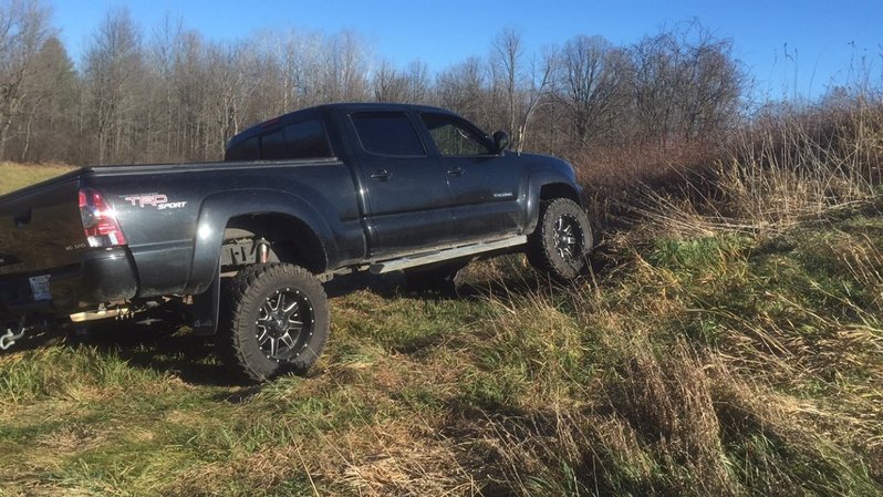

    So I ended up putting in a 3 inch toy tech lift with 33" and LR UCAS, drive Amazing.
