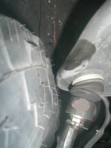

    Today I got lifted 3" and bought some NTG's 285/70/17 on my stock 17" Sport wheels. The guy installing them assured me that they would not rub at all, but they do rub some, and he said it was on the UCA's.
    I am going from Jacksonville, FL to Des Moines, IA to pick up a small car and haul it back starting this Monday, and am concerned that I am going to screw up these tires. I'm not sure that any local shop sells Spidertrax, and the closest place I could pick them up on my way to Iowa is outside of Birmingham, AL.

    I agree with hodge- run the stock tires for the trip, then get it sorted out afterward. If thats not an option.... then idk. Maybe a pic of the issue would help. Does it rub all the time, or just when turning? pics would help out.

    This is the best picture I was able to get. The space is about the thickness of a door key.

    Wow, yeah run the stocks until you get the spacers. That is just too risky especially with the long haul you are about to make.

    go get 1/4" spacer for the front from auto zone. I ran mine, 285's stock wheels and 1/4" spacers, for about 15,000 miles, with no problems. the 1/4" wont fix all the uca rubbing but It will give you some comfort room between the sidewall and uca
