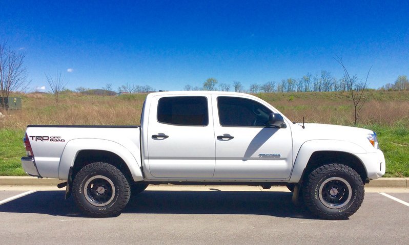

  4. Apr 4, 2016 at 8:06 PM
    #44
    Mjordan
    Mjordan Well-Known Member
    Jul 19, 2012
    #82994
    157
    Michael
    Denver, Colorado
    2015 Super White DCSB 4WD TRD Offroad
    TRD Beadlock Wheels, Bilstein 5100s all around, BFG K02 265/75R16, 20% tint, WeatherTech Floormats, LED Interior Lights, Tailgate lock, Salex Organizers, Shorty 5" Antenna, LED license plate lights
    Here's the KO2's after my TRD Beadlocks were installed this weekend.

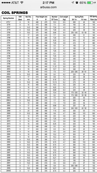

  19. Apr 4, 2016 at 10:27 PM
    #59
    xTacoma16x
    xTacoma16x Well-Known Member
    Dec 10, 2015
    #171934
    227
    TRD sport 2016
    You are correct 884 is 1" on 3rd gen. 883 is same as stock 2nd 375mm image.jpg
