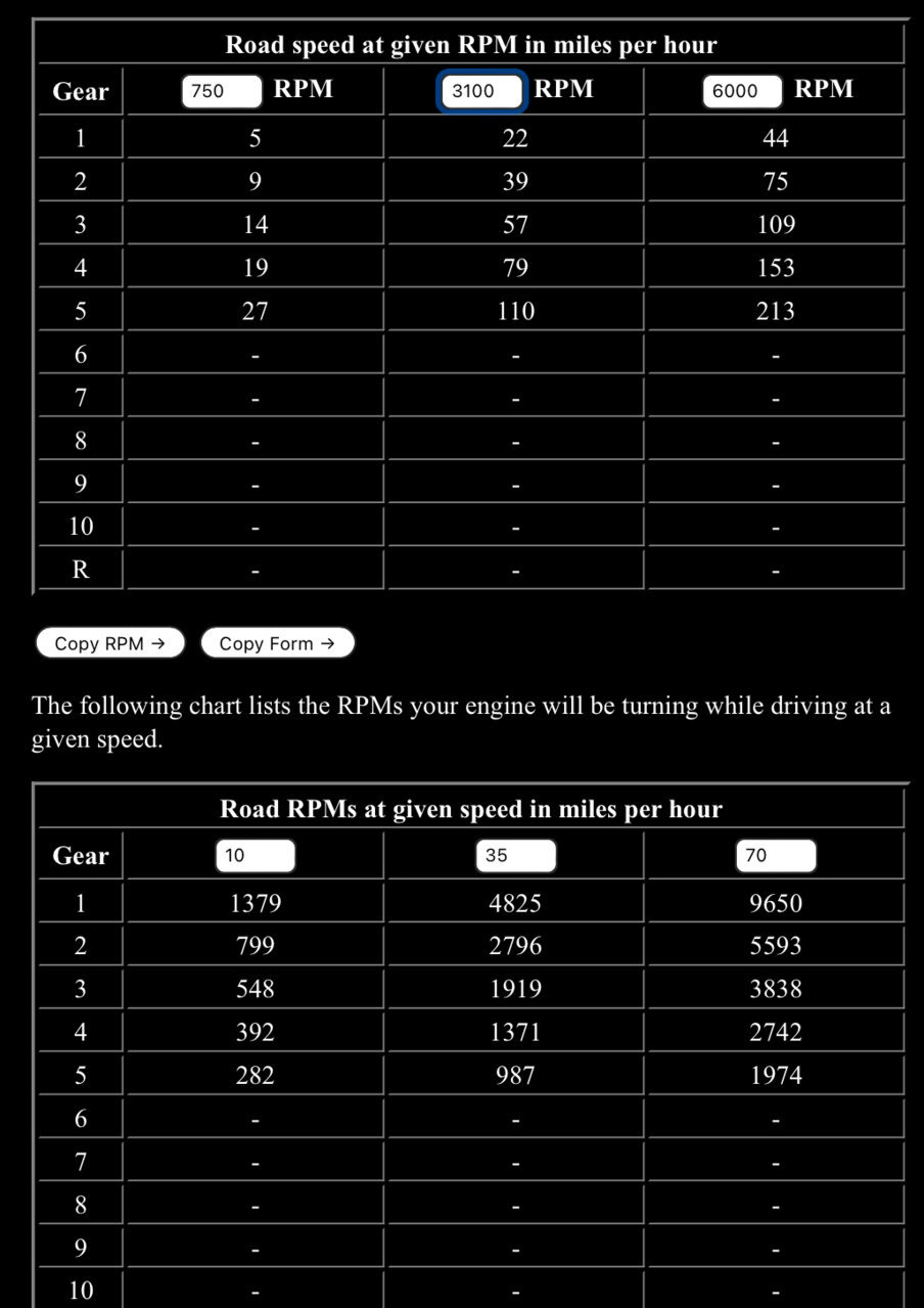

    Something doesn’t add up with your truck.
    It’s right for your buddies.
    Here is a chart with your tire size, gear ratio, and 3.73 gear.
