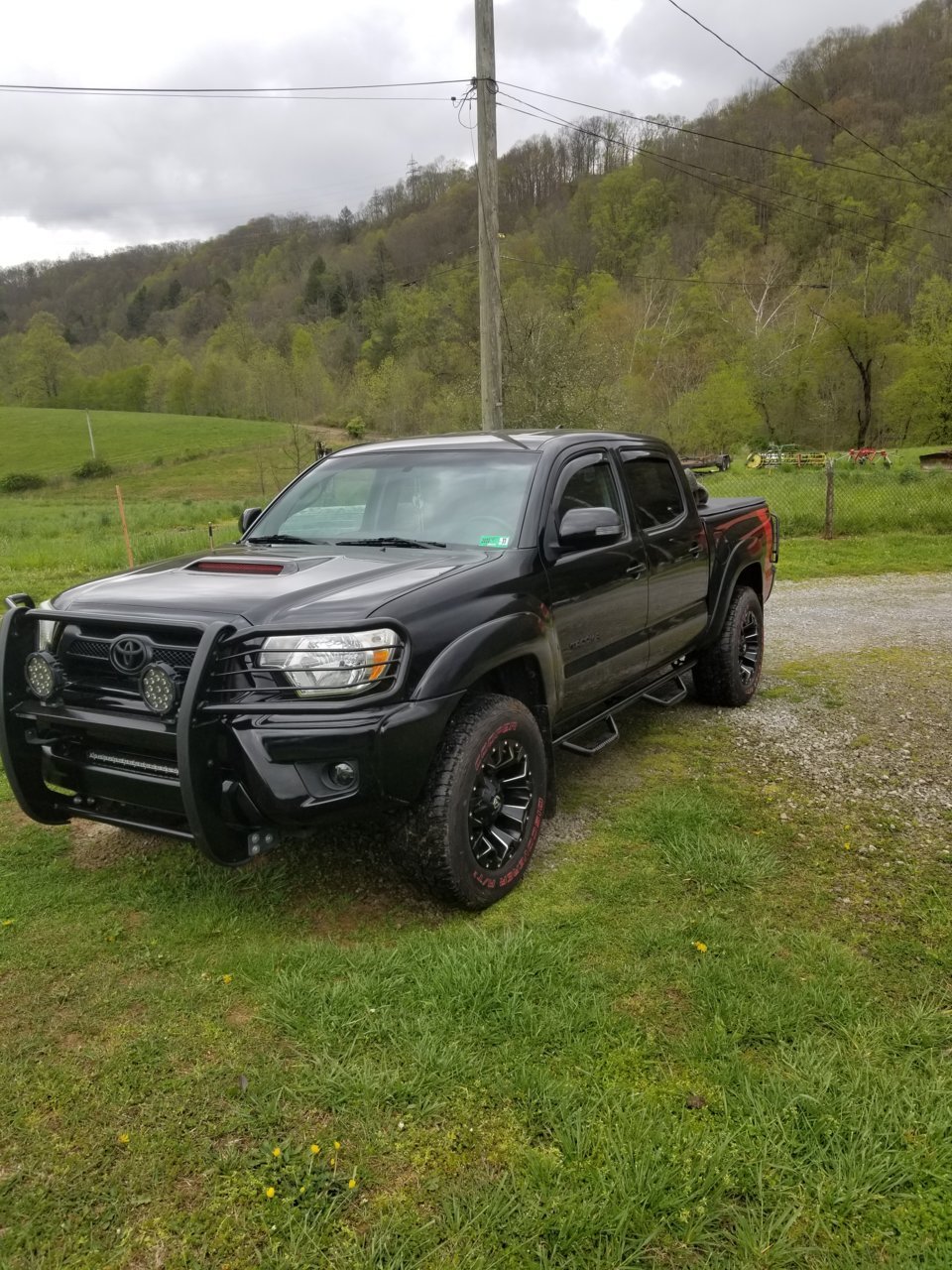

    I had a 3 inch in the front and 2 inch in the back block/spacer leveling kit installed and was wondering what would be the max tire size i could put on with out chopping on the truck. My wheels are fuel assault 17×10 with -12mm offset. Thanx pic is before the headlights and level kit but ill upload a new pic when i take one.20200424_165437.jpg

    Without rubbing? 265/70r17 or 255/80r17. Any larger and you will rub, lift or not.
