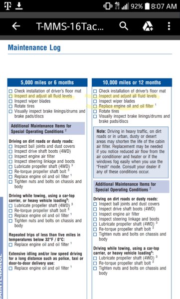

    If the dealer does not check, just show them this. If they still don't check, call corporate.
