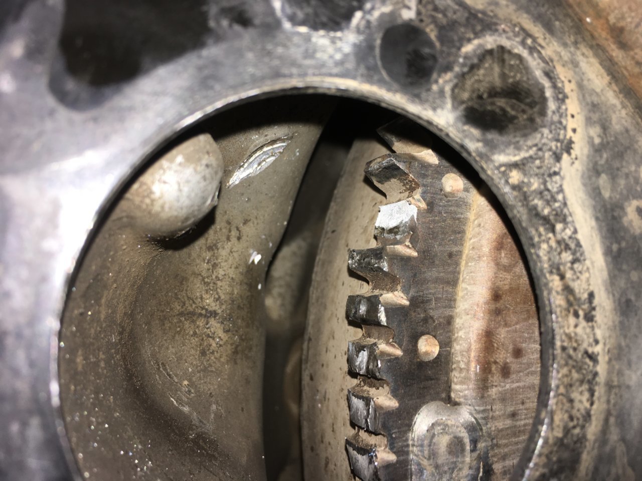

    Has anyone done a write-up or a video on a flywheel replacement on a 3.4 w/auto trans? I think mine is damaged. I had to replace my starter due to some grinding noises. With the new starter in, there are still some minor sounds while starter is engaging. Not sure how to check the teeth without separating the trans and engine.

    It’s definitely a problem with the flexplate. Removed the starter to get a look.

    There’s an inspection plate on the transmission. It’s facing forward from the bellhousing on the bottom.
    I’ve replaced my flex plate before, it’s not fun.
    While you have the transmission off, REPLACE THE REAR MAIN SEAL! Even if it’s not leaking you might as well replace it.

    I did find the cover. Wasn’t able to see anything due to the angle. I pulled the starter back off and took a pic through that hole. That showed me the damaged teeth.
