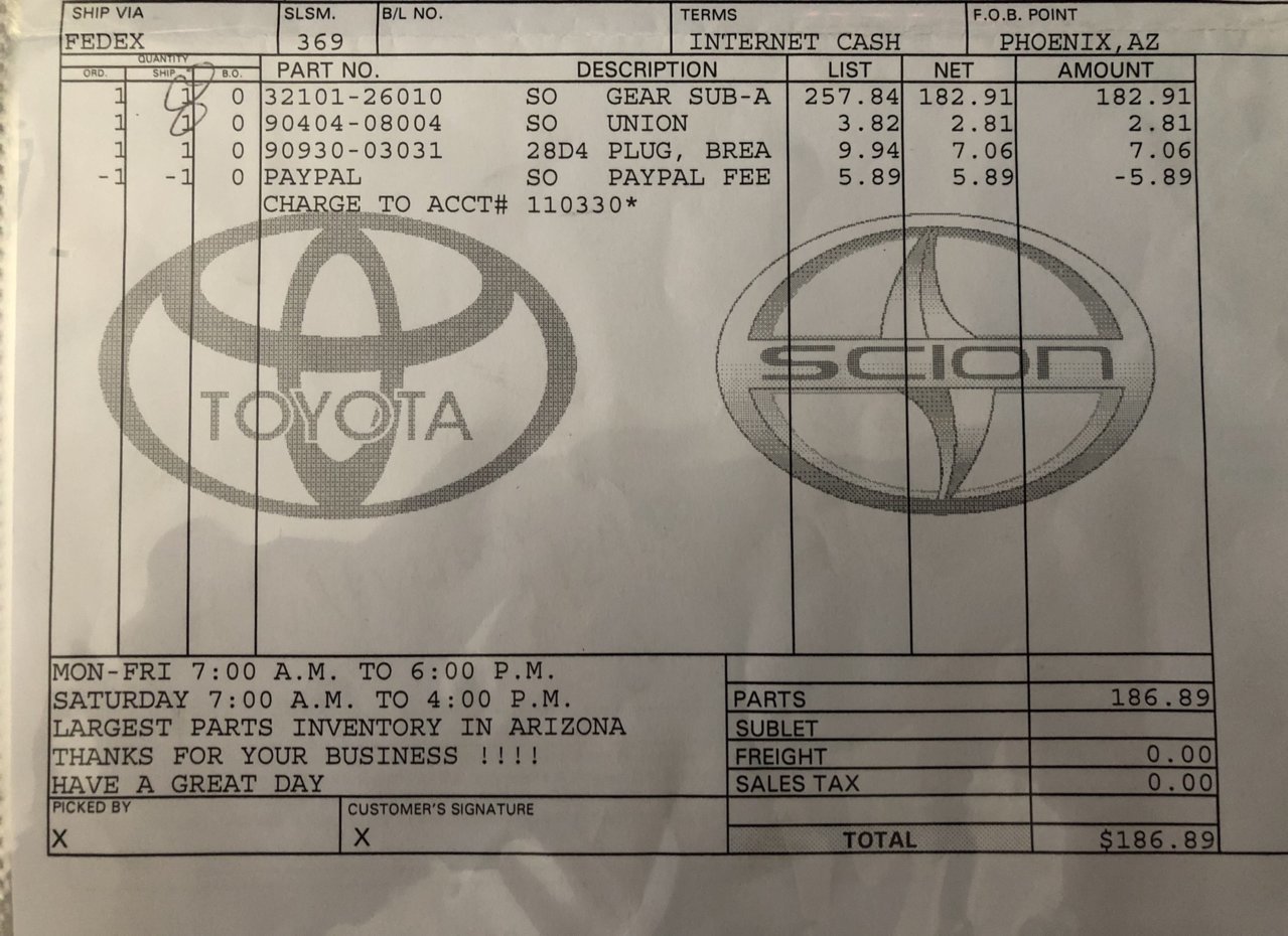

    My flex plate from Camelback Toyota was $182.91, that dealer was robbing you.

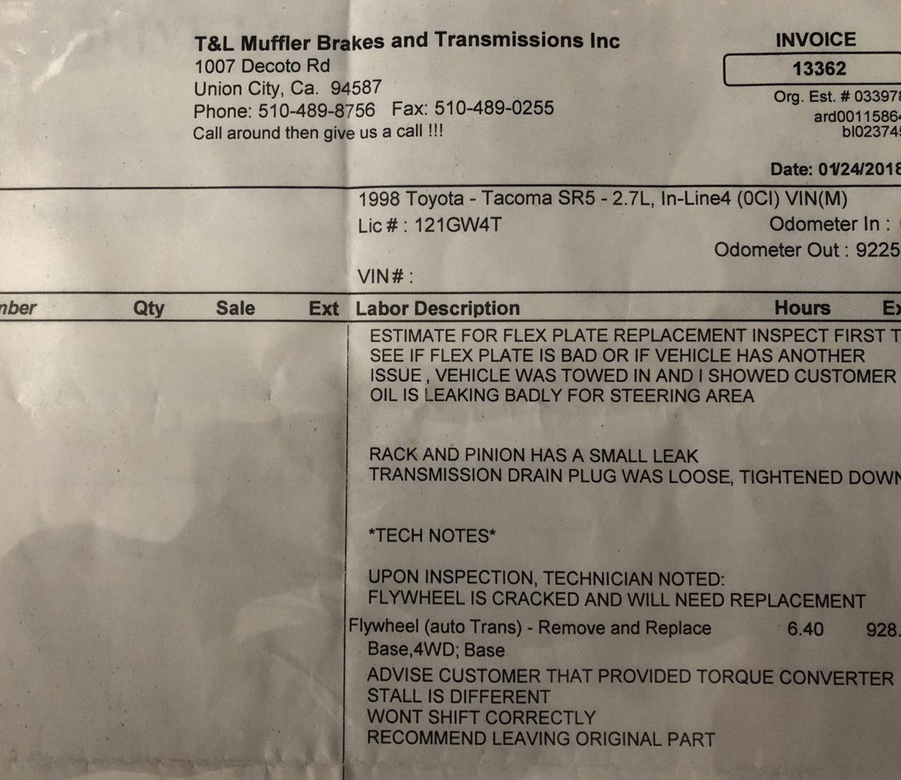

    Here’s my invoice from the transmission shop. $928 in labor with customer supplied flex plate.

    I asked my mechanic the same question. He said “Would you risk having to take the transmission off again because you cheaped out the extra $100 what a new flexplate would cost?”
