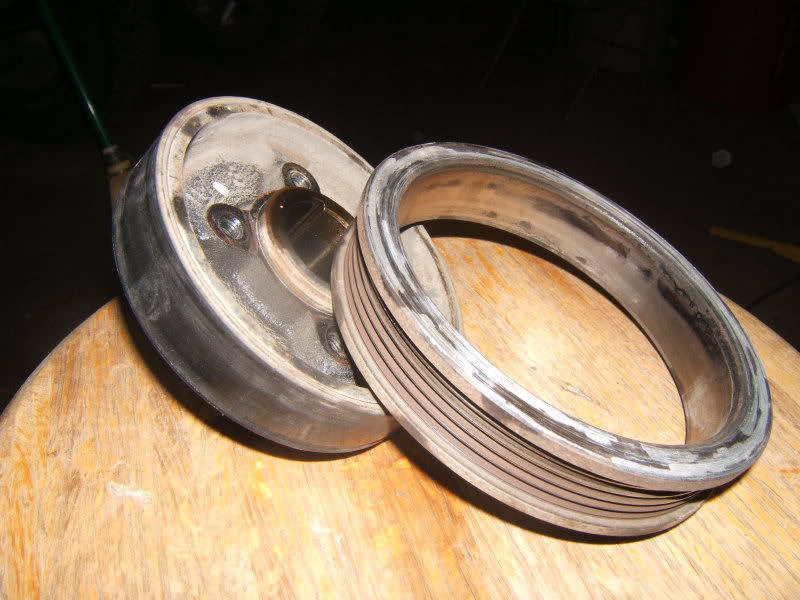

    Actually, don't use a 3 jaw on the outer ring, use a 2 or 3 bolt puller on the inner threaded holes.
    And use a coned center or flat foot that cover the bolt hole in the crank
    If it's really stuck you could pull the outer ring off the rubber and inner hub.

    Yeah, what he said /\. 1st gens take a 2 bolt puller. In the absence of any corrosion the pulley will side on and off by hand.
    Ending up with this will be a continuous source of embarrassment.

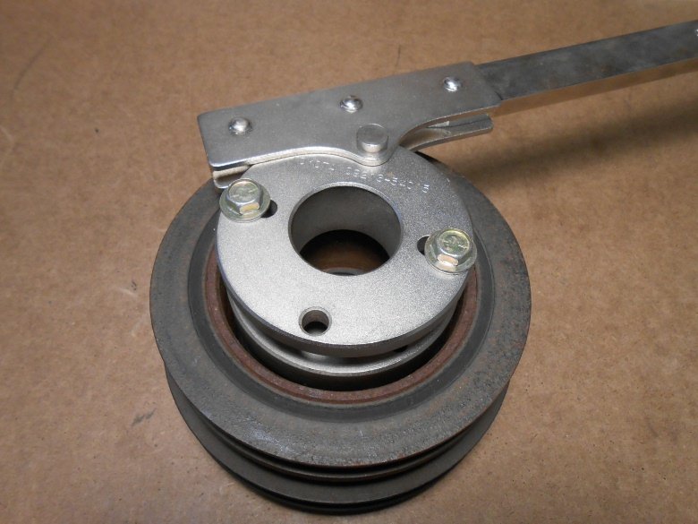

    When selecting bolts to thread into the 3.4 pulley hub keep in mind it's stamped sheet metal (thin) not cast like the previous pic. Don't be forcing things.
    3.4 pulley with "crank holder tool" bolted up.
