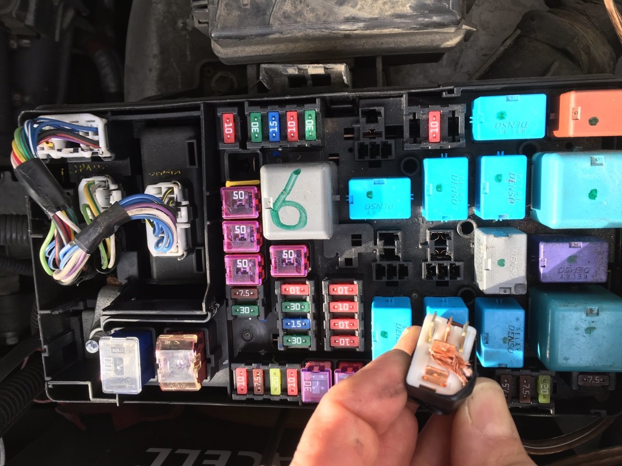

    So happens that I have the same problem on my 2013 Tacoma V6, it started 2 weeks ago, I'm still searching for a real solution.
    Meanwhile, I stumbled on a diagram and made a temporary jumper from battery to the center pin of fuel pump relay (sharpie red).
    When the problem surfaces I jump it, start the motor and disconnect the jumper.
    I am still waiting for the problem to be consistent enough to actually start looking for the actual cause.
    I'll be tracking your progress.
    Good luck
    Tom

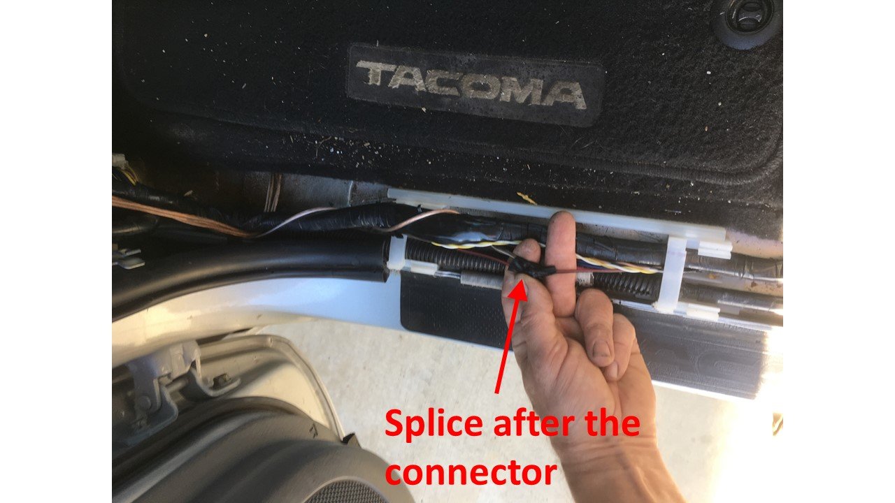

    PROBLEM SOLVED!!
    The bypass to the relay, mentioned above, was very temporary and eventually ineffective.
    I followed the red line in the schematic attached. However, I found my problem to be not in the relays or breakers, or other aforementioned components, but at the cable harness connector that's on inside the cab right next to the parking brake. One of the connector pins lost contact, arced and burned out. So happens that this pin carried current to the fuel pump. . .At that, I ran a bypass from the wire section before the connector to a wire after the connector.
