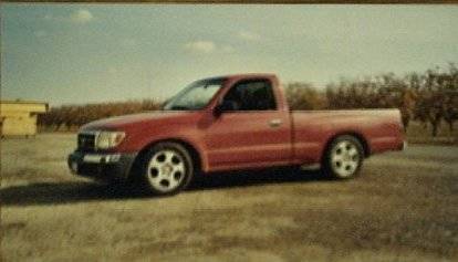

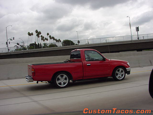

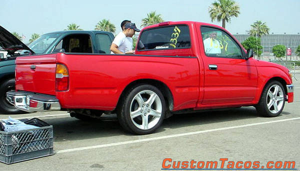

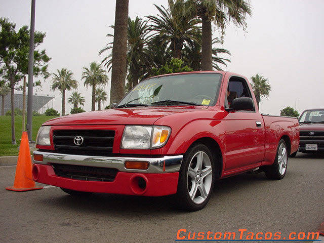

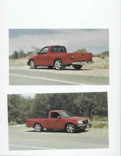

    We need some more pictures of lowered tacoma's. Here is mine from over the years...The details are located in my member gallery. All pictures were with a DJM 3/4 kit. Flipping of the balljoints, new upper control arms, angled aluminum blocks.

    everybody pay attention...THAT is the RIGHT way to lower a truck!

    Hows the ride with the DJM kit? I'm thinking of one for my 09 Taco and could use some input.

    I no longer have the DJM kit on my truck. When I did have it, it rode pretty good. I didn't notice much of a difference in ride. The kit doesn't change suspension travel. You won't have a rough ride because the coils aren't cut. All the kit did for the 95-04's was put a 4" block and reposition the balljoints. The coil springs stayed the same. The shocks might give a stiff ride, but it wasn't annoying. My stock height truck feels the same as when I was lowered.
    If you were to cut the coils, that's a different story....
    I am not sure on the 05-09 kits since they have a coil-over front suspension and the 95-04 didn't.
