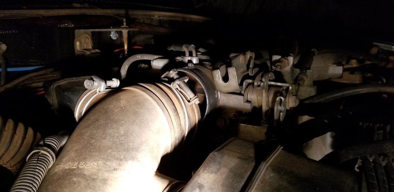

    Found it.

    So the issue is that your air intake hose came loose?

    Also makes sense haha
