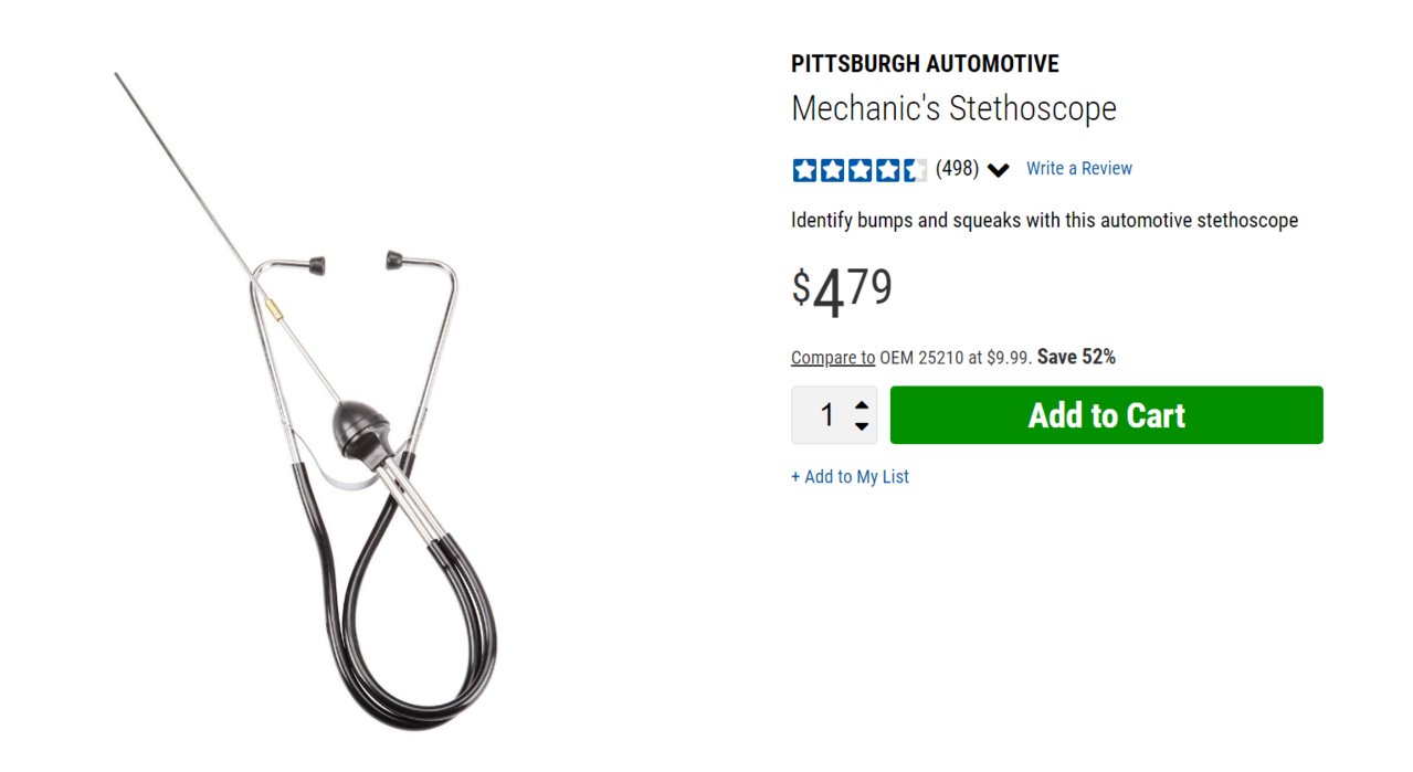

    I replaced the engine in mine at 225,000 miles. It had a morning death rattle. The previous owner neglected the cooling system and let it run too hot. Mine sounded like bad wrist pins.
    The PO replaced the heads, water pump, and radiator in an attempt to fix this issue before giving up and trading off the truck. I would probe around with a mechanics stethoscope to determine if the noise is from down deep or near the valves or an exhaust manifold tick that goes way when warm. IMHO - yours didn't sound that bad.
    If it is a serious engine problem, it will get worse over time.

    Found at Harbor Freight or any parts store. Helps pinpoint the location.
