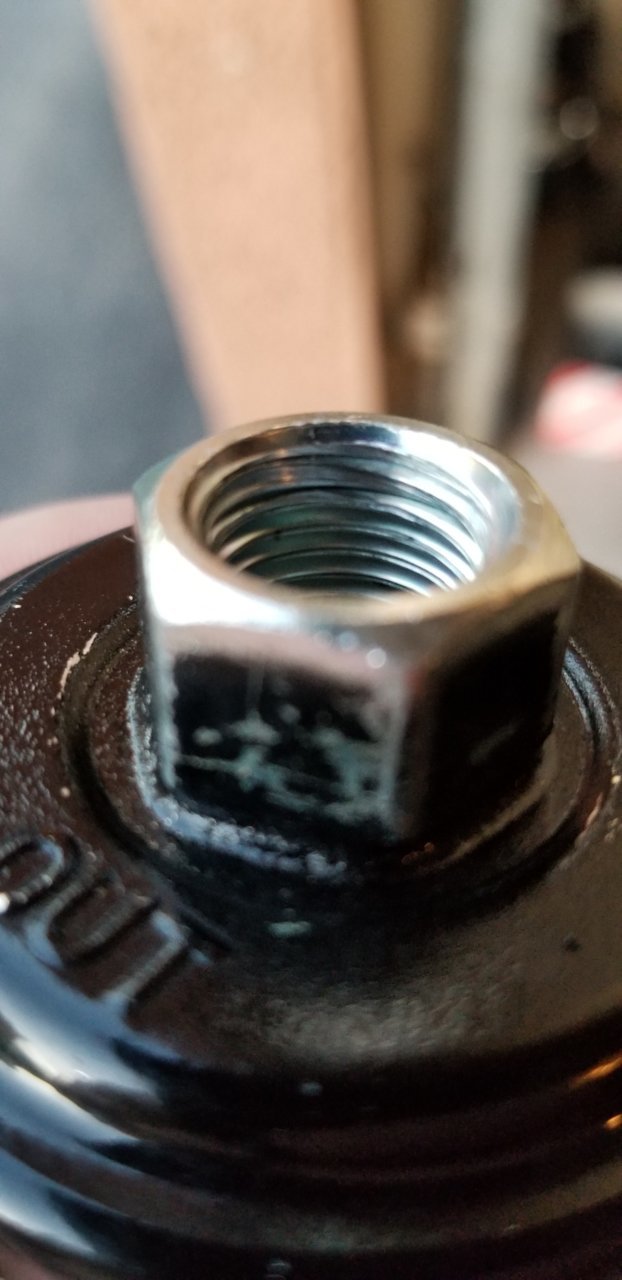

    So the OEM one I got didnt thread cleanly. I tried several times then gave up and took it off again. I was comparing it to the old one and noticed some threads messed up in the new one. 20180517_193431.jpg 20180517_193442.jpg the duralast ones threads are all okay but I didnt try to put it back on. So I ended up putting the old back in, again. I'll go back to the dealership tomorrow to swap this one out.

    I always use Toyota Fuel filters buy a few at a time .
    The only problems I every have is on the first change the lines are seized to the inside of the nut .
    Now I use never seize on the lines
    The smallest piece of grit or dirt will cause a flared fitting to leak
    if you remove the gas cap it should stop the gas coming out of the tank after the line drains
