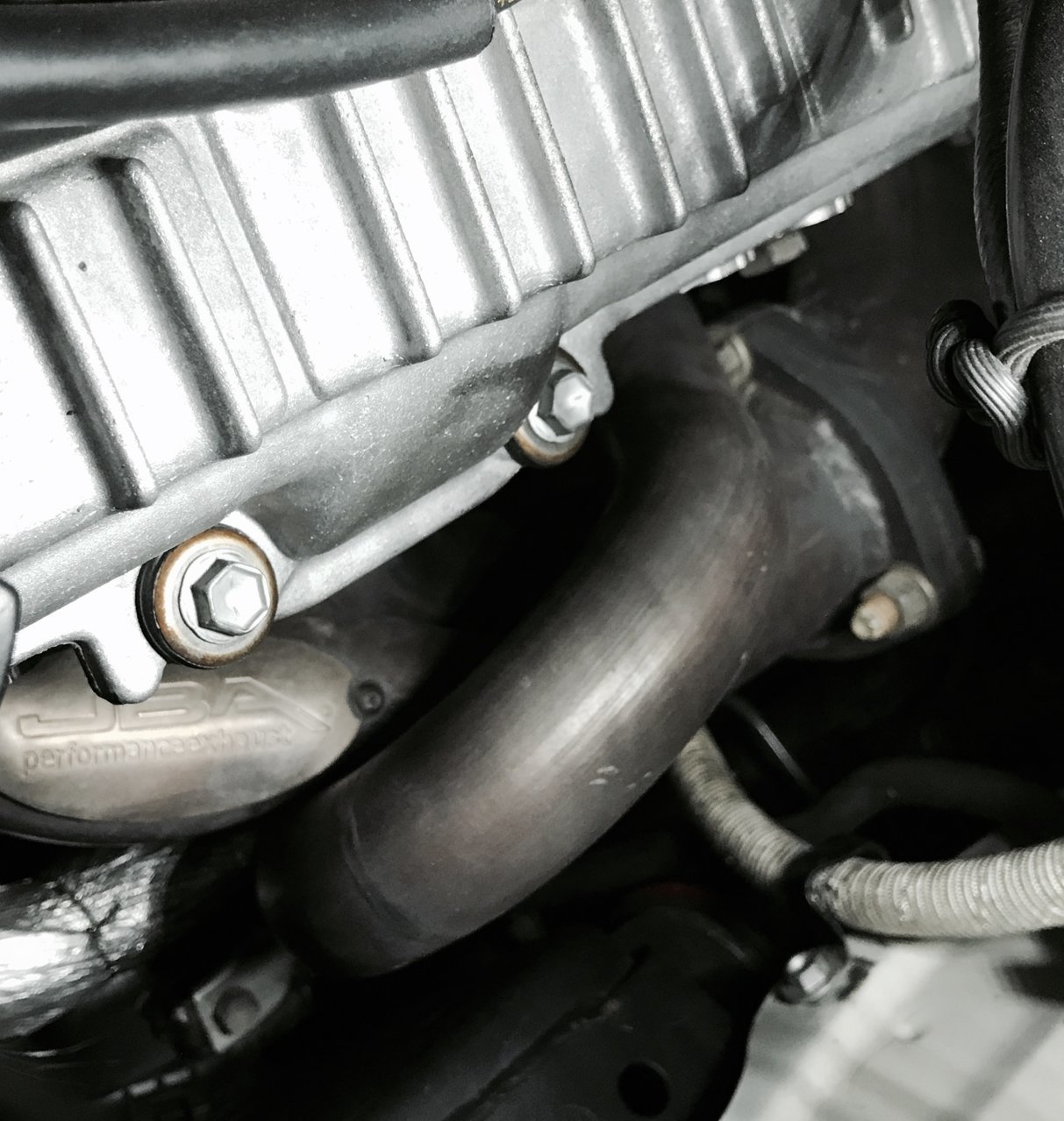

    IMG_1445.jpg No Y pipe needed, I'm rocking JBA headers, they're stainless and make good power! my friends with chevy's think I did a V-8 swap lol. If you do it yourself you're gonna cuss for two days straight if you've not done this before and don't have assistance! I did it in 12 hrs wont ever do that again unless I pull the engine. They are worth it especially if you supercharge it and if not. Experienced exhaust shops charge for 18-24 hrs labor for installers that have done the install. I highly suggest if you get a good set replace all the nuts/bolts with stainless as most kits get rusty bolts after a year, most have crappy hardware, address it before you have to replace rusty bolts later! Here's a pic of mine five years strong notice the rust on the bolts, stainless is coming soon!
