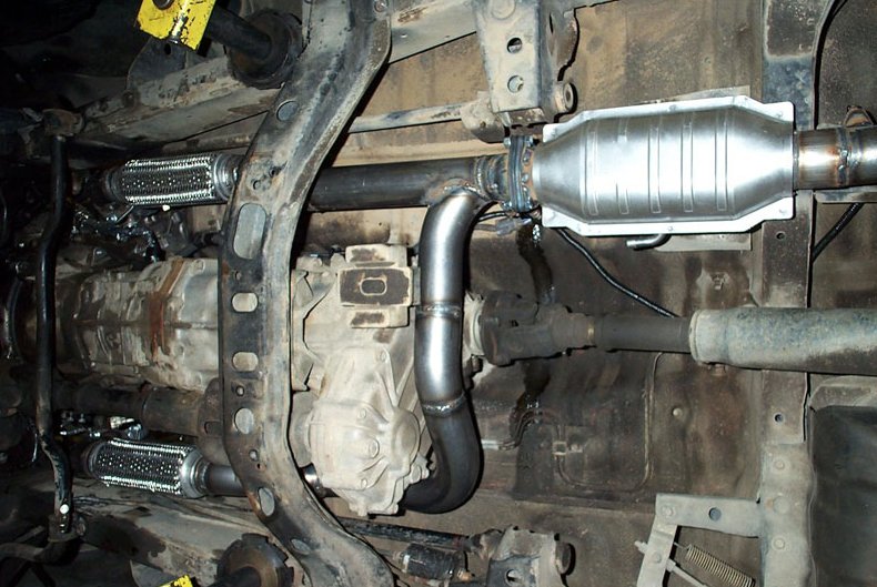

    do you think itd be feasible to custom route exhaust down both sides of the engine and have them collect right before the first cat like this?

    Yep, they do have a set for a 3.4 that drop down both sides check out URD. Gadget is a member and vendor here he could get you the right set I bet.

    Yes. I had to delete one in order for the headers to work. One cat Tacoma now.

    I was wondering that until I just visited gadgets site 95.5-00 completely bolt on. The 01-04 welding required..

    I swear I've seen that setup in stock configuration before with a crossover further up under the tranny! However you could probably buy just the headers and no crossover connection if you went through pertronics and are outside Ca smog type laws. Then you could make a setup that rivals that, what you showed would theoretically have more flow! I like the flex pipes that's a idea JBA should follow.
