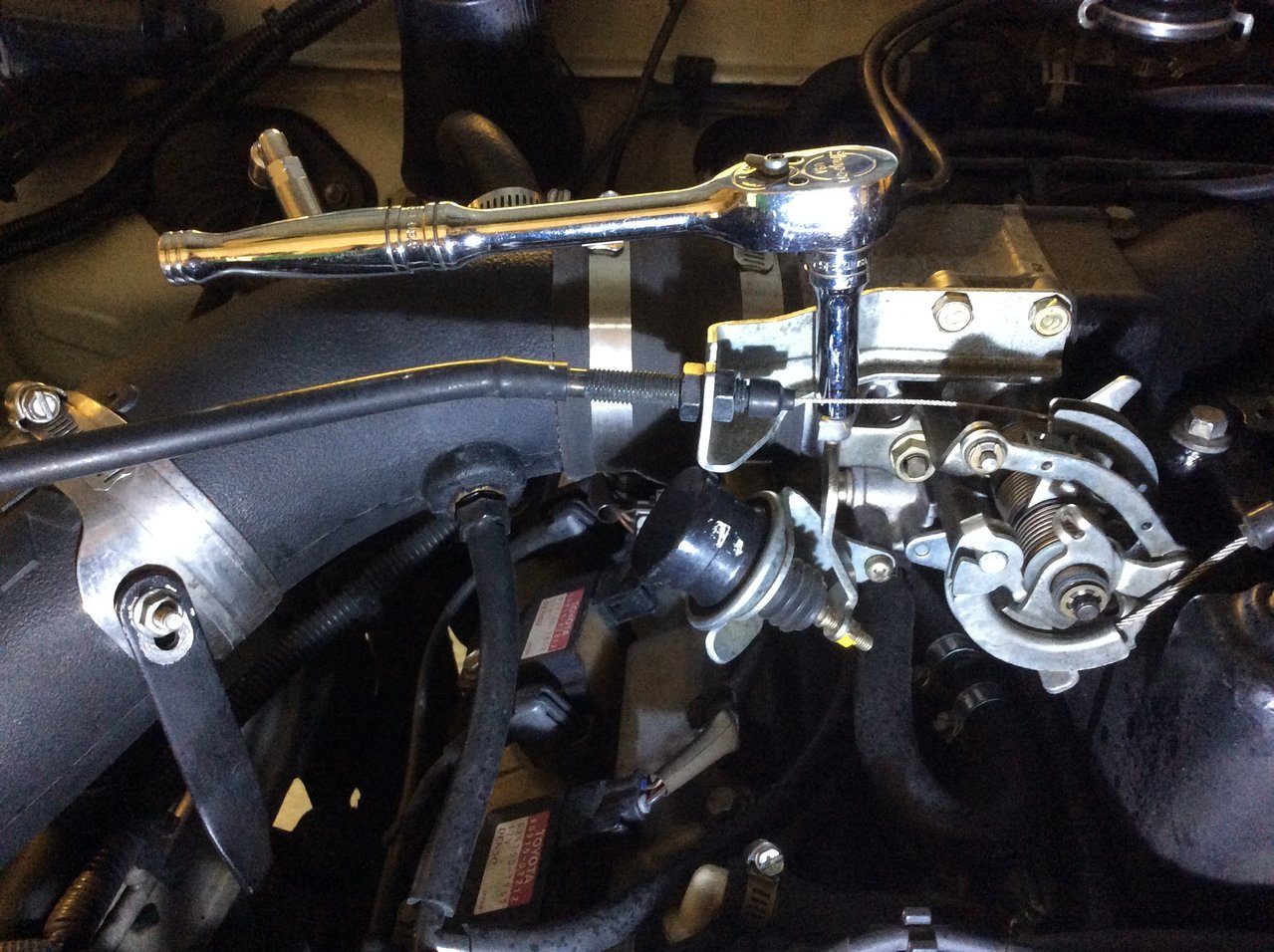

    Does you throttle body have the little vacuum dashpot that slows the throttle closing or kicks it up?

    Yup, 3 days ago it was idling at 1300 rpms all day,
    Last 2 days it's back down to 900 rpms
    I did have a p0120, that i cleared and has not come back

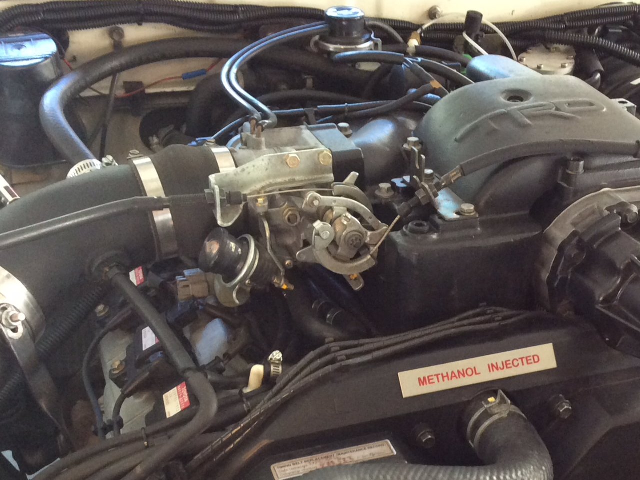

    Not to detract from thread, but I love that white sticker with red lettering towards front of engine bay:D:thumbsup:

    It's brushed aluminum with laser cut in letters and painted red in the letter cutouts.:)

    I checked the pod, no it's not holding up the linkage.
    I did decide to just toss in a newthrottle position sensor for 50.00 and the rpms went up to 1300 rpms from 900 on this day. I did play around with oiling the linkage and was able to adjust the nut to get it to 700 rpms with the new
    throttle body sensor.
    Will see what happens this week
