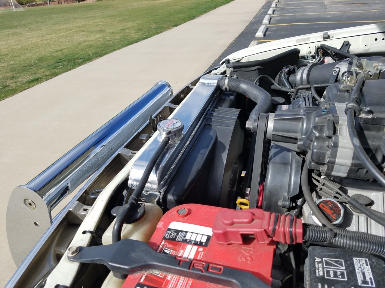

    100% worth it. The automatic transmission is far happier being "back in range" to turn the tires. Feels like stock again.

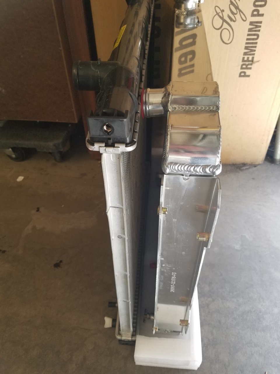

    One thing that happens with the radiator is the AC condenser sweats onto
    the radiator on that foot print area and the radiator ends up getting all plugged
    up from dirt and grime that sticks to the radiator in that area. My radiator was
    as thick as mud behind the condenser area. You could not even see the plugged area unless
    you removed the radiator. The stock radiator is pretty crappy in quality.
    The Champion radiator is absolutely the way the go. Your temps will
    stay around 190. It’s a 3 core radiator all metal including the petcock instead of stock single core and more than twice as thick,
    NO plastic parts to break. On warmer days at idle stuck in traffic the temp has gone to 195 at 700rpms.
    But if you rev the engine to 2000rpms it goes back to 190 in less than a minute, so it’s very efficient.
    Driving temps for me are always in the 190 range. My hottest spike was 195 at idle with Ac on stuck
    in traffic for 30 minutes going no where.
    The Toyota heads are made of aluminum with a cast iron block.
    To much heat to the aluminum heads means a blown head gasket from running
    your engine to hot.
    If your engine is running hot get it fixed ASAP
    For 200.00 it’s a bargain!!!

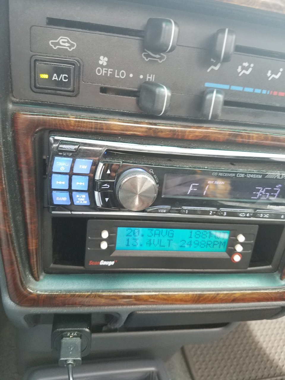

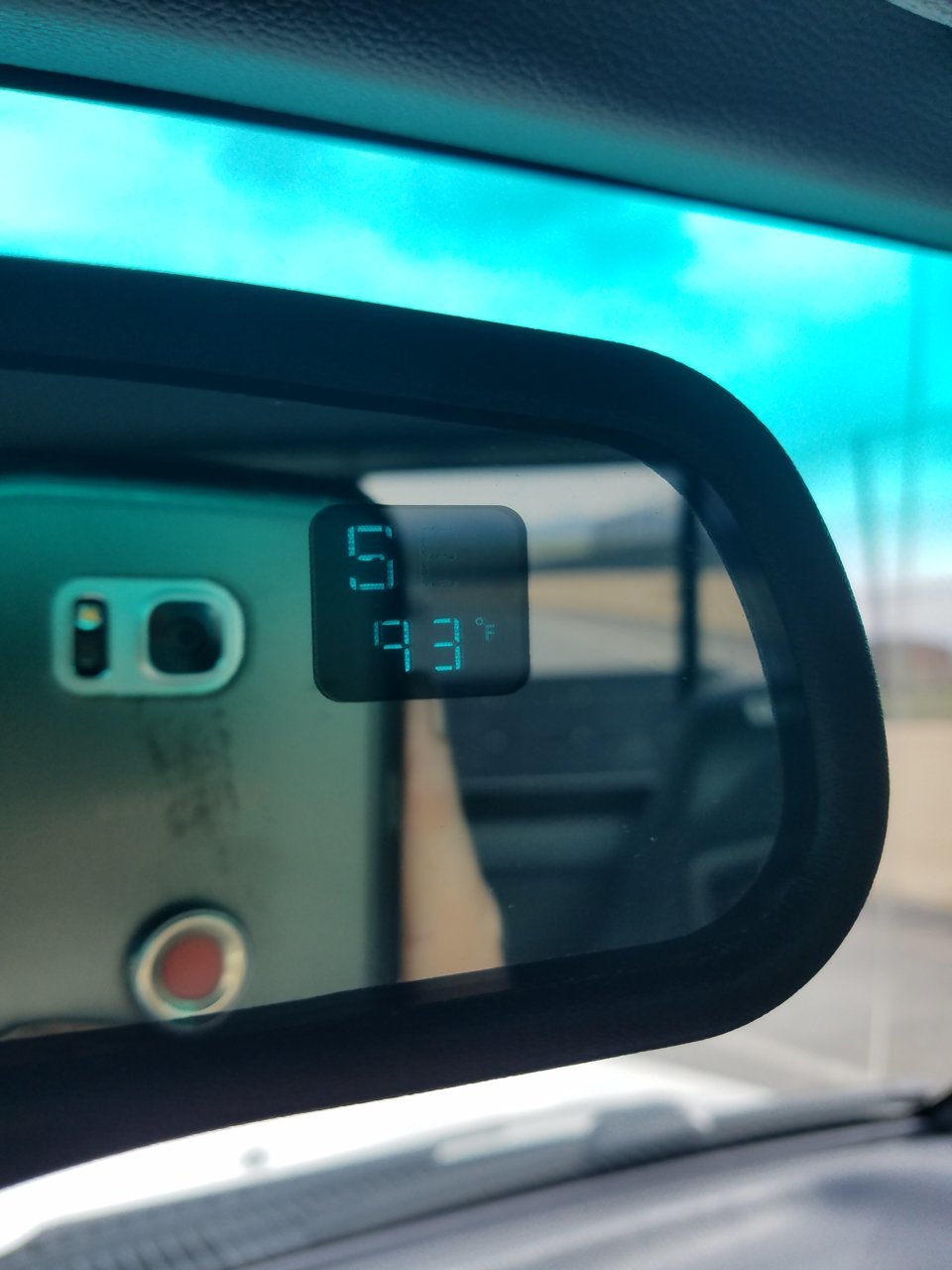

    Loving the new radiator,
    93 degrees outside
    AC on
    20 mpg
    Radiator temp 188 degrees
    Thumbs ups:)
